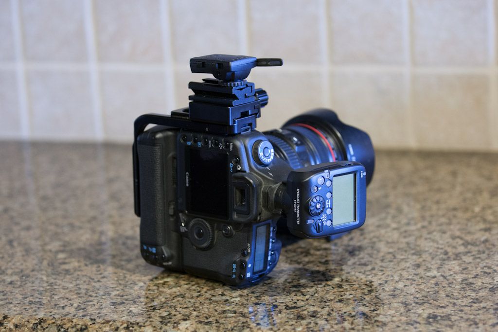

I can see the advantages to running the skyport through the PC jack with the ST-E3 in the shoe. I usually keep a RRS L-bracket on my 5DII and I can imagine a small arca clamp with a cold shoe clamped to the left side of the camera might hold the skyport nicely. It might be a little less "contraptiony".

Well that's fine and dandy when you can take your time. But when it comes to weddings, you need something reliable and fast. Very fast. I don't have time to put on a bracket, plug in pc jack, connect a trigger to the adapter, put the adapter on the hotshoe etc etc...
Nevermind how i'd carry it in a small convenient bag...

This is just a quick mock-up but might work well with a smaller clamp and a low profile cold shoe like the one Jerry used.
