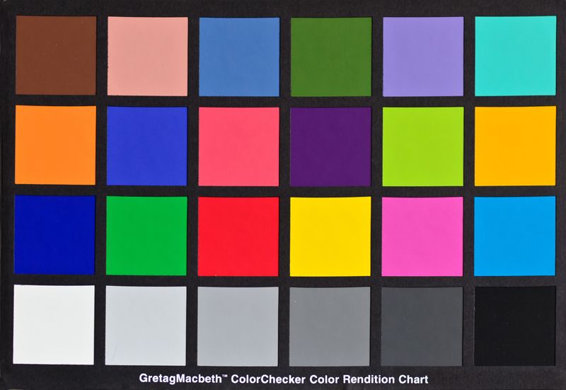

I soft proof using the EZPrints profile and require zero adjustment for color. I do need to use a bit of Curves to primarily adjust contrast and maybe tweak brightness a bit. What are your soft proof settings? Here's mine:
IMAGE: https://photography-on-the.net/forum/images/hostedphotos_lq/2012/10/5/LQ_621648.jpg
Image hosted by forum (621648) © Bob_A [SHARE LINK]
