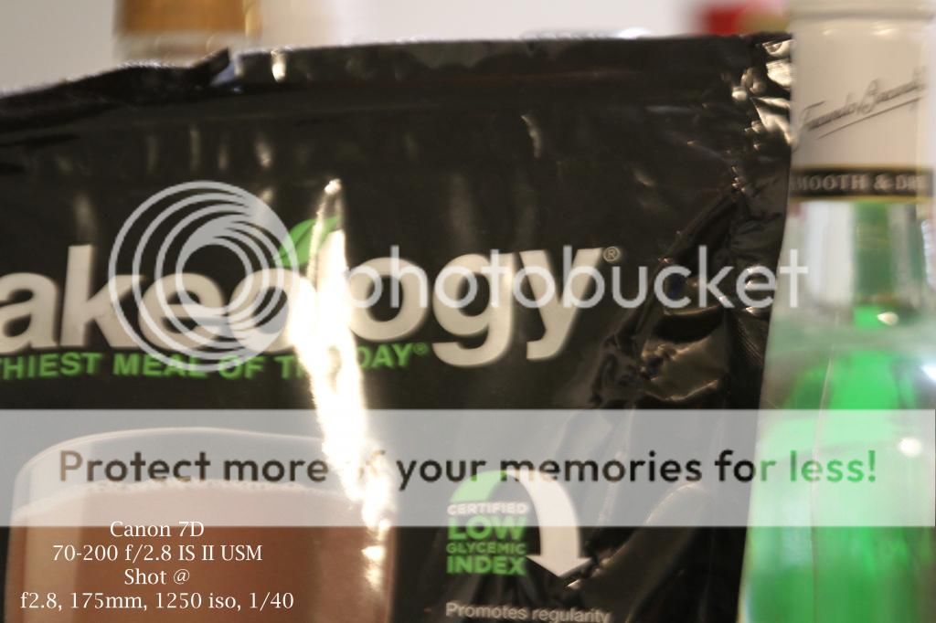

Tripod used for both shots, focused on the G

Nov 01, 2012 18:40 |  #14
http://i1027.photobuck​et.com …20Shots/TestSho​t123mm.jpg (external link)
http://i1027.photobuck​et.com …20Shots/TestSho​t175mm.jpg (external link)

Nov 01, 2012 18:45 |  #15
how good is your tripod and head? 1/40 on a good tripod should be tack sharp but it kinda looks like motion blur to me. specially on the 175mm shot. the smooth and dry text on the bottle has cues of motion blur.
