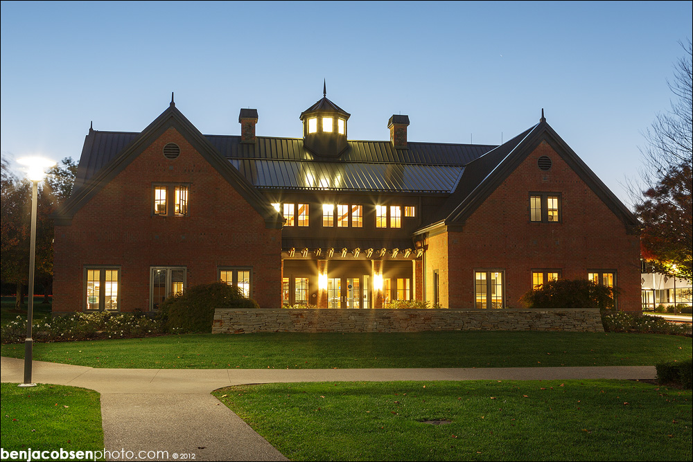

Looking to get better "starbursts" in my arch shots. I've got a 16-35II and it does an AMAZING job at this... Here's 2 examples:

My 24-70 2.8 (the original) doesn't do so well however:
IMAGE: http://www.benjacobsenphoto.com/blog/wp-content/gallery/collaborative/canon-eos-5d-mark-iii-bjp_8410.jpg
what other mid range zooms do a better job? Part of my issue is I also shoot people and weddings occasionally so I've used the 24-70L because it's the best compromise. I've thought about the 24-105 but I don't really want to give up the stop. IS and range would be nice though. Ideally I'd own the 24-70L and the 24-105. One for people/low light/2.8, the other for landscapes and arch with IS when needed. But I can't really afford both. The 24-70II also comes to mind but it's also expensive...
Any suggestions?

i think i know what you're looking for, and it comes down to aperture blades.
if you count the points in your first shot with the 16-35, there are 14, which is 7x2. the reason there are twice as many spikes than blades is that the 7 blade aperture is not symmetrical, so the diffraction spike from one "side" bleeds over to the other "side," effectively doubling the number.
on your 24-70 v1, there are 8 blades. with an even number, the spikes will superimpose on one another. i suspect what is happening is that the superimposed spikes tend to bleed into one another and cause them to be not as well defined. perhaps there are tiny variations in the position of the aperture blades (or more specifically, the corners where two overlap) which cause them not to be perfectly superimposed.
on the 24-70 v2, there are 9 blades. the 50/1.8 has 5, the 1.4 and L have 8. the 24-105 has 8. the 14/2.8 v1 has 5, v2 has 6. 24L v1 has 7, v2 has 8.
so far, in the samples i've looked at, all of the shots with nice, sharp, distinct diffraction spikes have an odd number of blades. i had originally suspected that curved blades spiked less than straight blades, but i no longer believe that to be the primary factor--it comes down to odd vs. even.
judging by the fact that the upcoming 24-70 f/4 has a 9 bladed aperture, i suspect it'll have sharp points (and lots--18!--of them). my toke 116 has 9 as well, and i do like the bursts from it.

awesome, thanks Ken. Sounds like the 24-70 f/4 IS might do it, I'll wait out it's release (-vs- getting a 24-105 now) and see how it goes. Steve, I'd love to see some samples, but I'm afraid I can't afford one even if it was the only answer.

like ride5000 said, from my understanding, odd numbers of blades double the number of star points, whereas even numbers of blades have the same number of points as blades. so ideally (if you want a lot of points), you want a 7 or 9 bladed aperture (for 14 and 18 points, respectively).
From what I see, the rounder and/or smaller (further away) the source of light, the better.

OK, looking at some of the specs of lenses I've owned Ken's onto something. Seems like 9 is the magic number which both new canon 24-70s have as well as the sigma and tamron versions. The tamron 24-70VC just became more interesting...
