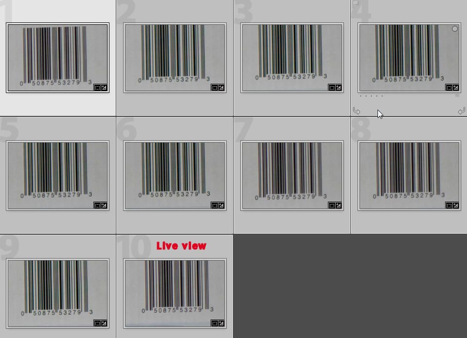

I just conducted an AF accuracy and repeatability test. I set a camera on a tripod, aimed at a barcode which is NOT perfectly parallel to the focal plane but at a slight angle (<30 degrees). The target was 56" from the focal plane (measured with measuring tape). Here is a shot of the overall scene...
shot on 40D, with 17-55mm f/2.8 lens set at 50mm f/2.8. The DOF zone is 1.25" deep.
IMAGE: http://i69.photobucket.com/albums/i63/wiltonw/fullAFtest.jpg
I used center AF point, focused with back button focus, then took a shot...did that 9 times. Then I put camera on Live View, zoomed in as much as possible and manually focused while looking at the LCD; took the tenth shot.
Here are all ten shots...
IMAGE: http://i69.photobucket.com/albums/i63/wiltonw/AFtrials.jpg
