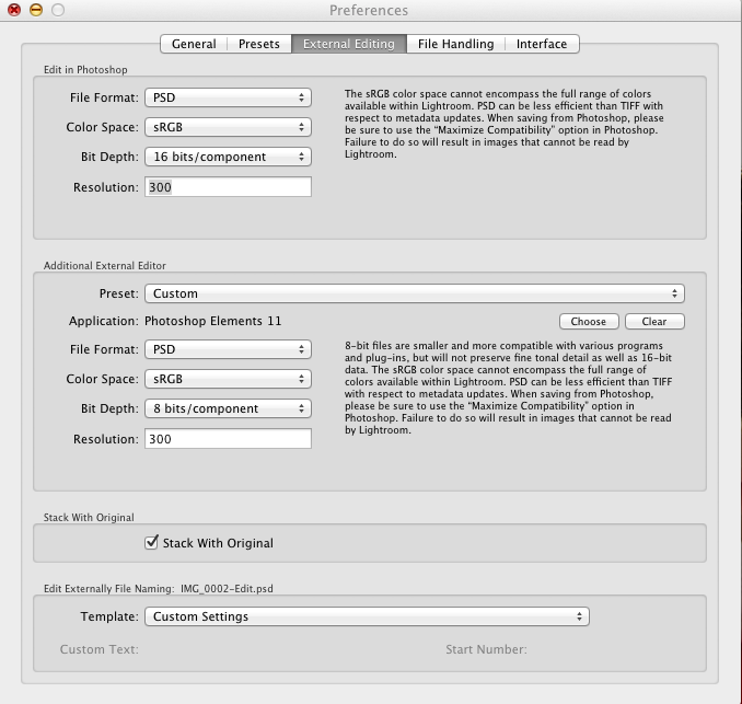

Im using elements 11, I have posted a screenshot of my external editing preferences, if they are any help.
IMAGE: http://i108.photobucket.com/albums/n39/pumba1906/ScreenShot2012-12-04at114138.png
It still wont work if i open Elements prior to exporting :( im using a iMac on os x 10.8.2

Might help:
http://feedback.photos​hop.com …4_external_edit​or_failure (external link)
http://forums.adobe.co​m/message/4252987 (external link)

yes, make sure you are calling "PhotoshopElementsEdit​or.exe", and not "PhotoshopElements.exe​" which calls the front panel where you can choose to organize or edit.

If you have LR4 installed before you install PSE, than lightroom does not automatically find PSE as the external editor. If you already have PSE installed & install LR it does. Found that out myself. I already had LR4 installed, installed PSE and had to go in and specify where the correct exe was for the external editor on the export tab. I had assumed it automatically picked it up.....;)
And my problem has been solved, Many thanks :)
