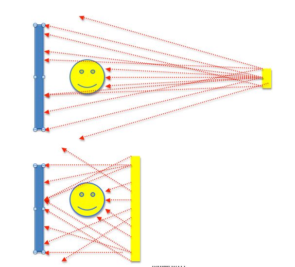

Light is photons, which is basically energy. Think of photons as specs of fine sand being flung in multiple directions. We cannot curve light. There is only one thing out there that can bend light - a black hole. This is simple physics and we are all bound to it no matter what we use. Light (photons) travels in straight lines.
Hard light. The first Illustration shows a 2' by 4' softbox placed 50' from the subject. I know you would not have enough power to light the subject from that distance but go with it for now. You can draw lines all day and you will not get light behind the head which will result in shadows. This goes for under the eyebrows, etc.
Soft Light. In the second illustration we have moved the softbox to within 5' of the subject. The light source is now close enough and big enough to get light behind the head. This is not due to any special baffles on the perimeter that causes this. Light is just scattered in all directions and at the outer edges some light (photons) winds up getting directed behind the head.
IMAGE: http://i33.photobucket.com/albums/d74/Zenon1/Light-2-1.jpg

Hard light vs Soft light is the size and distance of the light source to your subject. People use flip it's, flash benders, etc which are bigger than the flash head itself so it they help but are no substitute for large and close light sources. The flip is and others are also used when bouncing the flash off the ceiling. Some of that light reflects from the flip it towards the subject.
There is no magic bullet. If I have no other choice my flash goes on a bracket, ISO goes way up and the aperture is opened so the flash does not have to work so hard and I just shoot direct.
