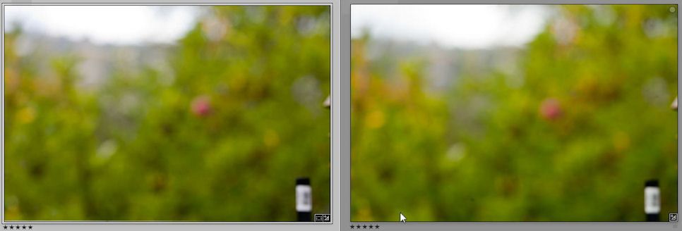

Here is a small section of the full image to show only background blur, both near background (object at lower right, apple 25' away) and far background (hillside 1 mile away), taken with 116mm f/4 vs. 193mm f/6.3 (almost the same diameter aperture, 29 vs. 30.6)
IMAGE: http://i69.photobucket.com/albums/i63/wiltonw/compare116193.jpg
'Bokeh' Amount of Blur
'Bokeh' = The aesthetic quality of the blur

Wilt, that's a great comparison!
I can't help but notice how much nicer the blur is on the image to the right. The "quality" of the blur is simply smoother and more aesthetically appealing, whereas the blurred area on the image to the left is somewhat "choppy"..
By the way, what lenses did you use to take these images? I saw that you mentioned 3 prime lenses earlier in your post, the 85, 135, and 200mm. And then you said what focal lengths they were taken at, 116mm and 193mm - so I am assuming zooms of some sort? Anyway, I just didn't see any mention of what lenses were used, and I am curious to know what they were.

Tom Reichner wrote in post #15423745 (external link)
Both shots were made with the same lens....70-200mm f/4 L IS
It is commonly discussed that bokeh 'wide open' can be considerably different than when 'stopped down'. In this case, the aperture was wide open for one shot, and partially 'stopped down' for the other.
