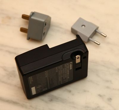

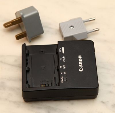

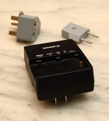

If you want to save space and weight when travelling, get an American style charger and 1 or 2 adapters. I find most hotels have the standard American plug in the bathroom for shavers and I rarely need to use the adapters.
