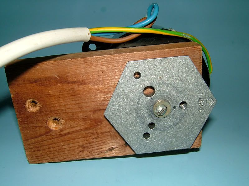

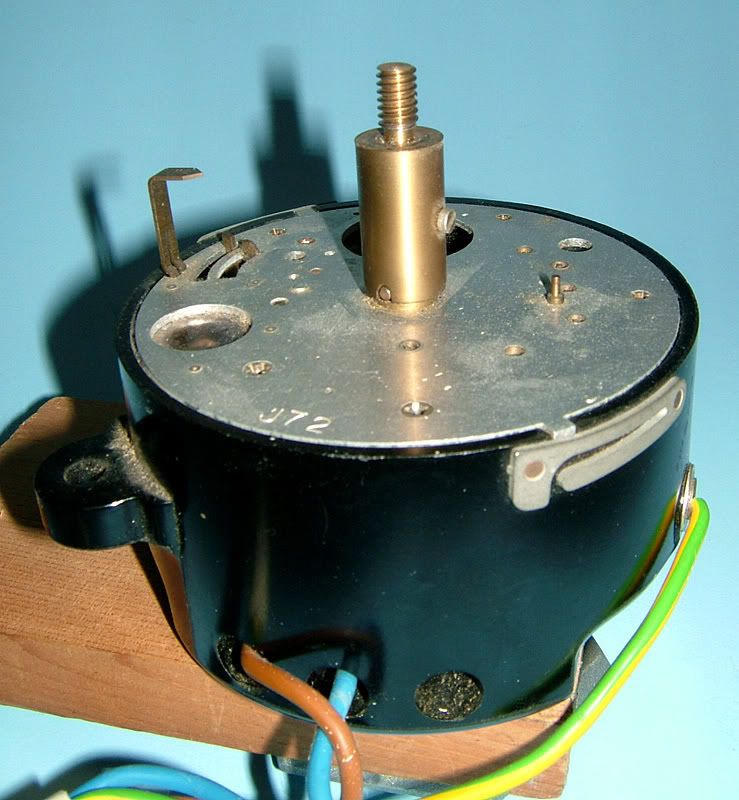

Here is the mount as it was set up for this image. It's an industrial 24-hr timer switch (used in the old days for switching street lamps on and off). The difference between solar time and sidereal time is insignificant for short exposures.
IMAGE: http://i72.photobucket.com/albums/i192/garlicpickle/Canon/DSCF1028.jpg
I got an engineer friend to make me a threaded brass adapter to go on the shaft of the timer.

The timer body is screwed to a piece of wood, and underneath I screwed a Manfrotto quick-release plate, so the whole thing would go on my heavy-duty tripod.
