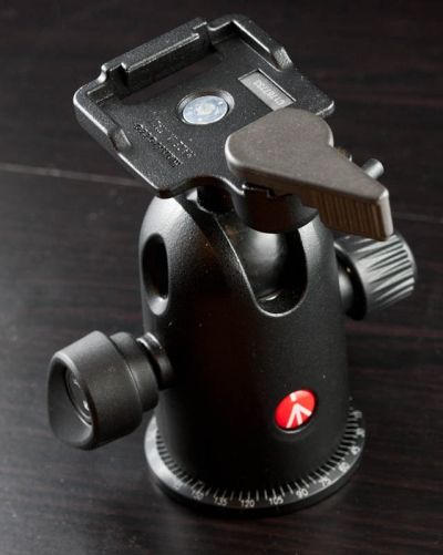

I attempted to remove the quick release clamp from the 488RC2. With the ballhead tightened all the way and pliers on the stem that connects the actual ball to the QR clamp, I was not able to remove the QR clamp from the stem. I was able to remove the QR clamp w/ stem from the ball though. Is this correct to attach a RRS QR clamp? The screws that RRS sell do not look like what I will need, so I am thinking the stem needs to be removed the QR clamp.
Looking at the top of the Manfrotto QR clamp you can see the stem and what appears to be threaded together, but not budging for me :oops:

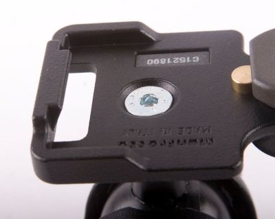

That sucks. The newer heads like the 498RC2 have a removable hex head screw in the top.

The 486 and 488 both have a 3/8-16 threaded stud that goes into both the ball and the clamp/plate. On mine I needed no extra work to remove them and put A/S clamps on in their stead. Later production ones may have been secured with Loctite, in which case you'd probably need to heat the stud to break the connection.
