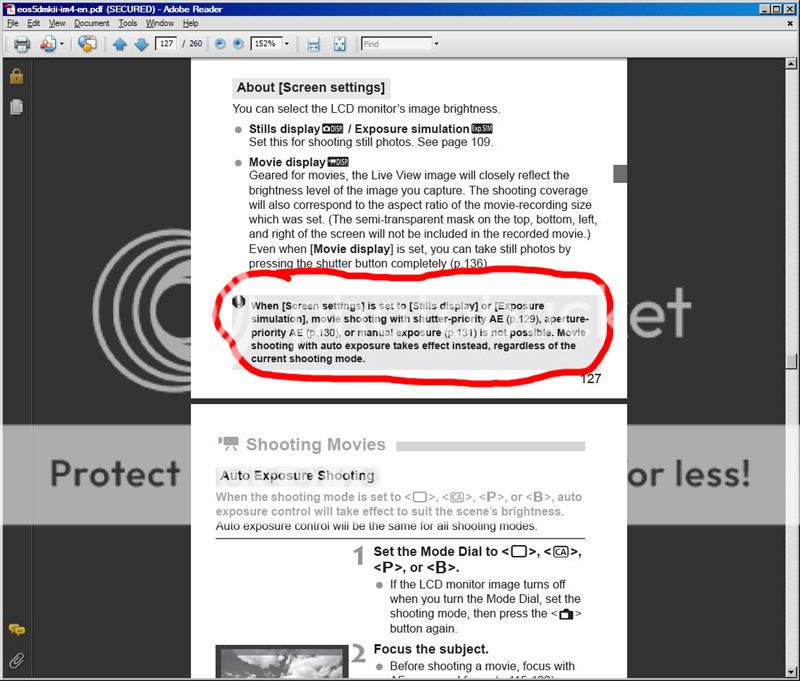

Maybe this?
IMAGE: http://i735.photobucket.com/albums/ww357/oldvultureface/POTN/untitled1-4.jpg

Ahhhh...that's it!! Thanks :) That's really odd, though...why would they do that??
