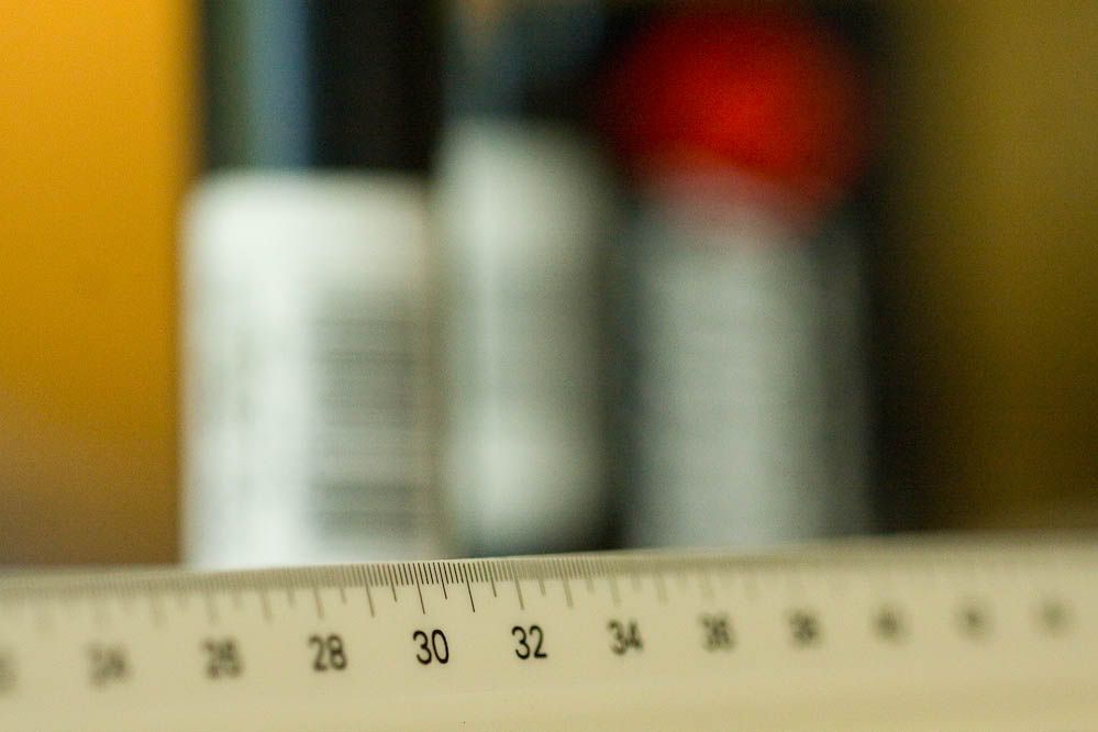

What I use...
IMAGE: http://teamspeed.smugmug.com/Electronics/FocusGenie-GelGenie/i-ZMssGBf/1/M/85c-M.jpg
That and brightly colored toys in the yard during the summer.... :)

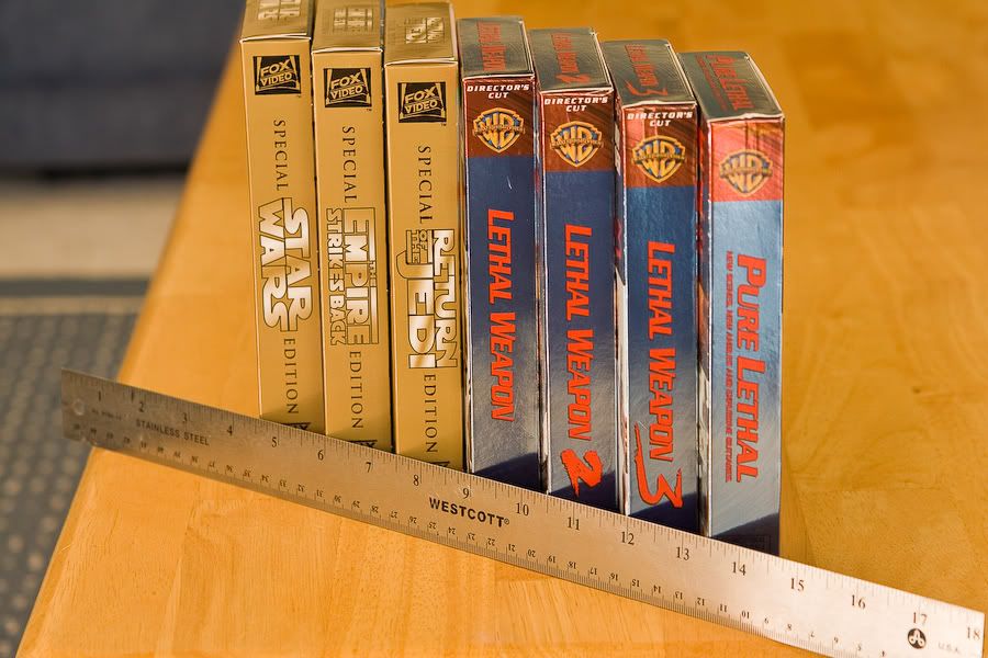

Mimic this...something PLANAR to focus on, with no ambiguity to the AF mechanism about what exactly to focus on or where exactly on a curve to focus!
IMAGE: http://i69.photobucket.com/albums/i63/wiltonw/IMG_3138-1.jpg
or
IMAGE: http://i69.photobucket.com/albums/i63/wiltonw/IMG_6990-1.jpg
Assessment (the '9' is aligned to the focus target surface
IMAGE: http://i69.photobucket.com/albums/i63/wiltonw/Focustestfullsize-1.jpg
The wrong kind of target (non-planar target)
IMAGE: http://i69.photobucket.com/albums/i63/wiltonw/50mm90mmf4-2.jpg

With any curved surface, how is the AF sensor supposed to simply 'know' that you want the front surface of the curve or 30 degrees along the curve or the edge of the battery (as seen in a 'projected' view)? Focus on A or B or C ??? Not FLAT, unambiguous target!!!
IMAGE: http://i69.photobucket.com/albums/i63/wiltonw/ambiguouity.jpg
If the sensor used the edge of the battery C, but you made the MA result in a sharp frontal surface A, you just adjusted the lens to front focus by doing that!

That is a pretty exaggerated example, unless you were using a round car battery. :)
Doing a battery test will invariably cause the entire battery to fill up a single AF point, and granted there might be a single AF motor step one position or another due to what part of the label caught the AF's "attention", but it would still yield that battery in focus. It should get you pretty close anyways.
IMAGE: https://photography-on-the.net/forum/images/hostedphotos_lq/2013/01/4/LQ_634212.jpg
Image hosted by forum (634212) © TeamSpeed [SHARE LINK]
