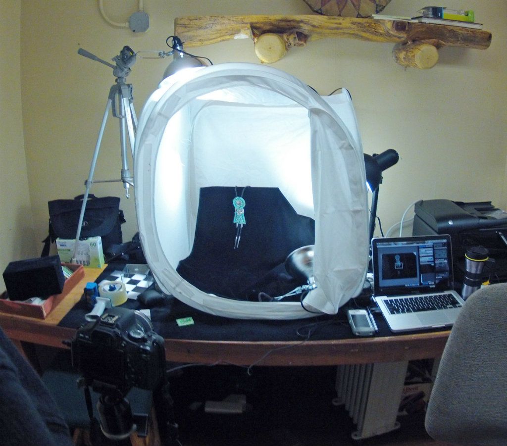

Anyway. Here's my setup and list of gear I've been using:
Canon Rebel T3i
Canon 50mm 1.4
Canon 60mm 2.8 Macro (supplied lens)
Manfrotto Tripod/Head
Two Clamp lights (eh)
Two kit lights (blah) that came with the supplied tent, all seen below:
IMAGE: http://i133.photobucket.com/albums/q64/yitzachm/GOPR0897-2_zps95b76a45.jpg

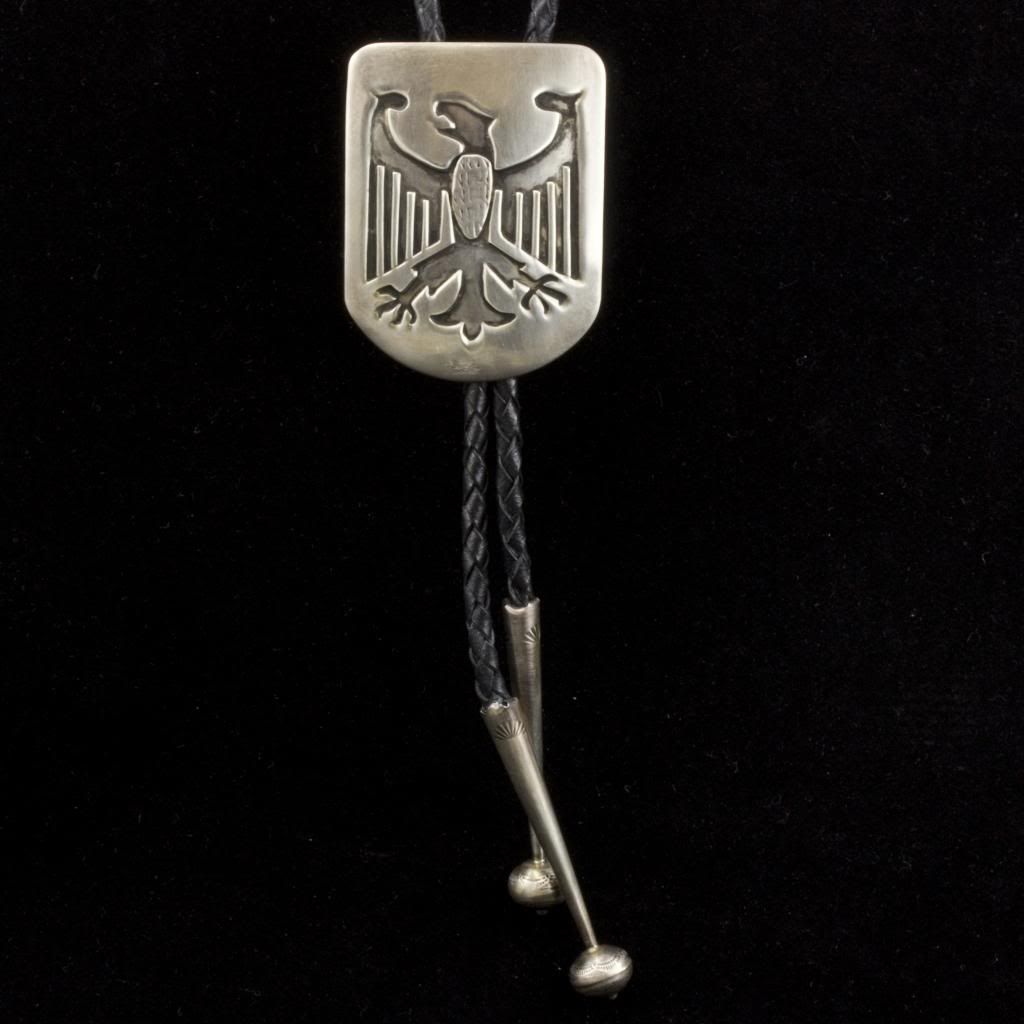

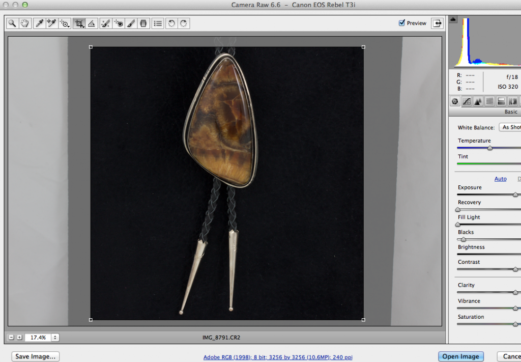

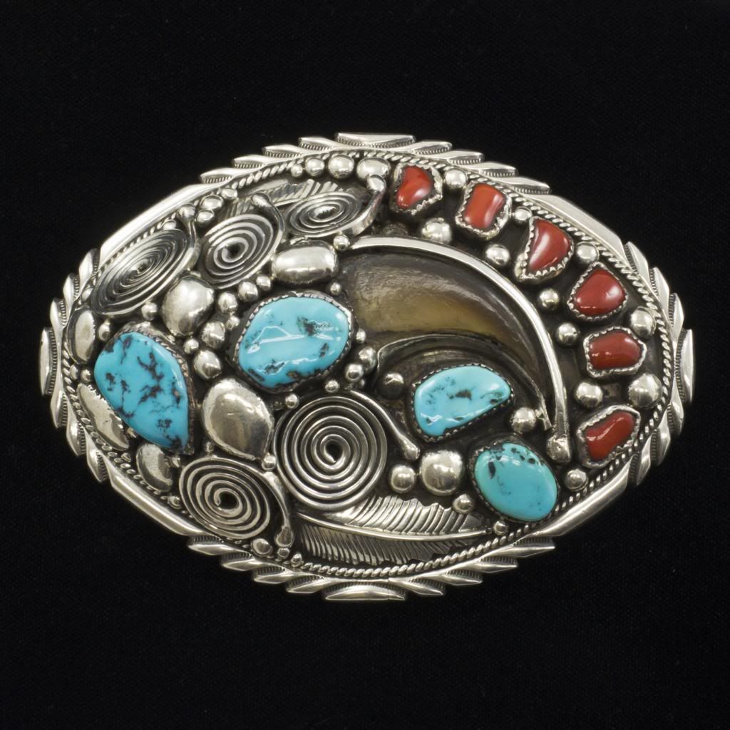

I've been shooting very high f/stop, as in 16-25, lower shutter speeds,
and thanks to ML, native ISOs of 160, or 320 for the most part.
I use the "mirror up" feature to further reduce any possible vibrations.
Online calcs tell me my DOF could be as much as 4-5" at the range I'm shooting at, and I try to sharpen a tad in Photoshop.
Also, I shoot RAW format only.
Still, I feel some of these pix are soft, and sub par. Admittedly, these are cropped... they have a website that needs 1:1 photos, so yeah they're cropped down.
I would love to hear insights and opinions!!

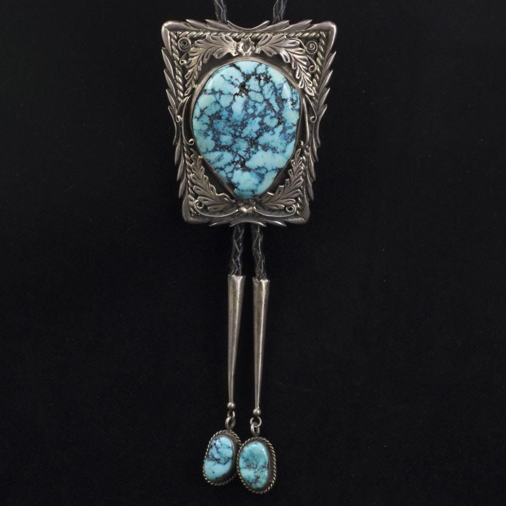

Lousy f/stop....somewhere near 8 IIRC
Lost the other EXIF data for the moment...
IMAGE: http://i133.photobucket.com/albums/q64/yitzachm/Buckle55_zpsdfd99d84.jpg

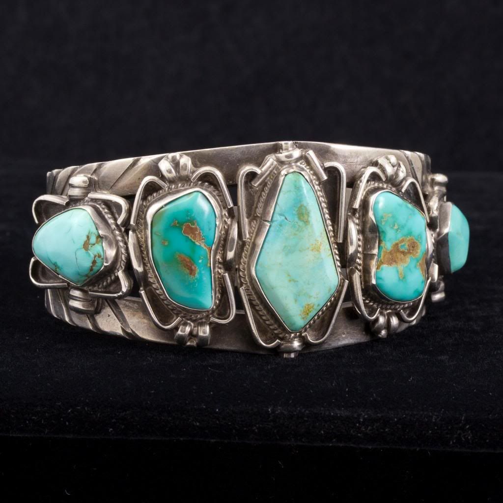

#2
f/29
1/3 sec
320 ISO
60mm
This picture makes me angry...because of how many times I retook it.
IMAGE: http://i133.photobucket.com/albums/q64/yitzachm/IMG_8764-2_zps2aa07a34.jpg

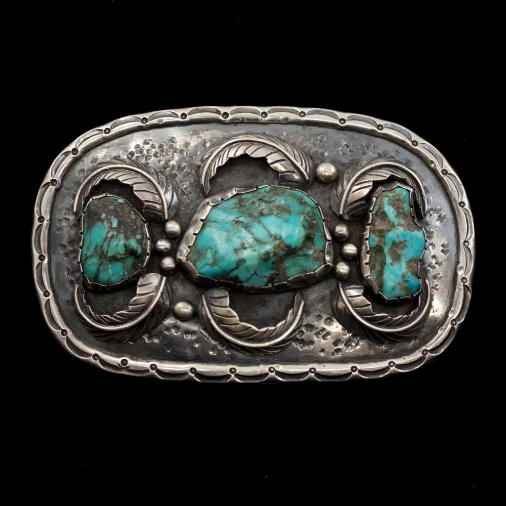

#3
f/16
1/5 sec
320 ISO
50mm
IMAGE: http://i133.photobucket.com/albums/q64/yitzachm/Bolo-551_zpsec6ff506.jpg

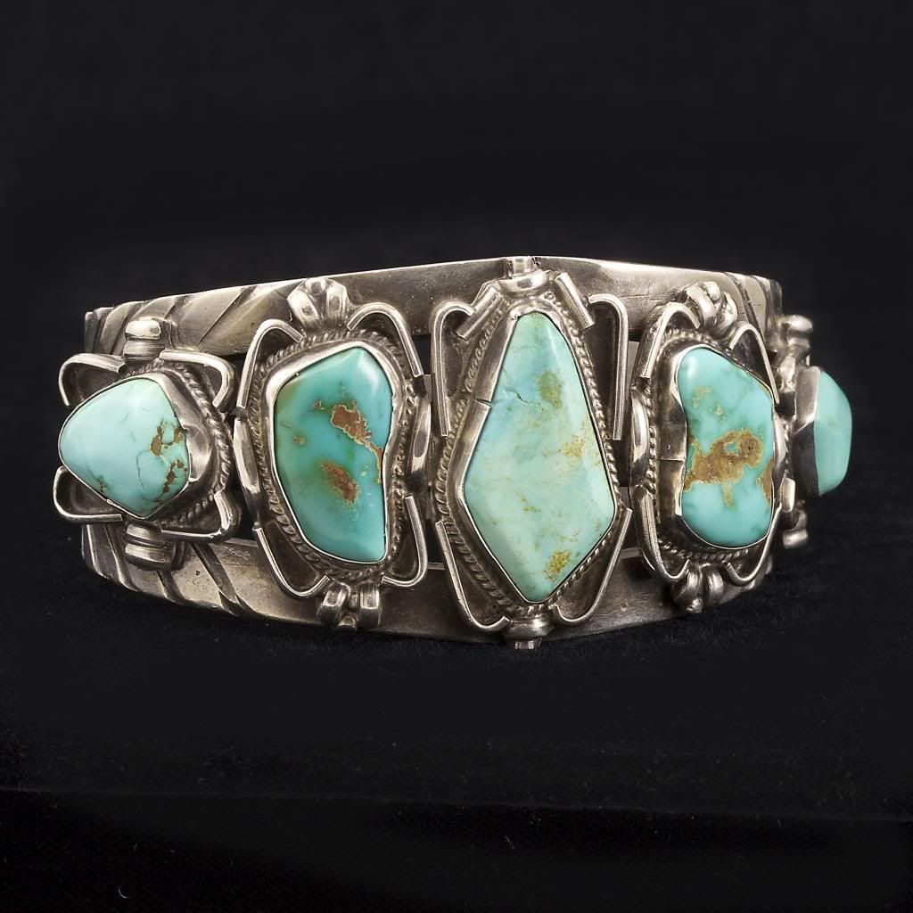

#4
f/22
0.8 sec
160 ISO
50mm
IMAGE: http://i133.photobucket.com/albums/q64/yitzachm/Buckle-111_zpsc03c4e60.jpg

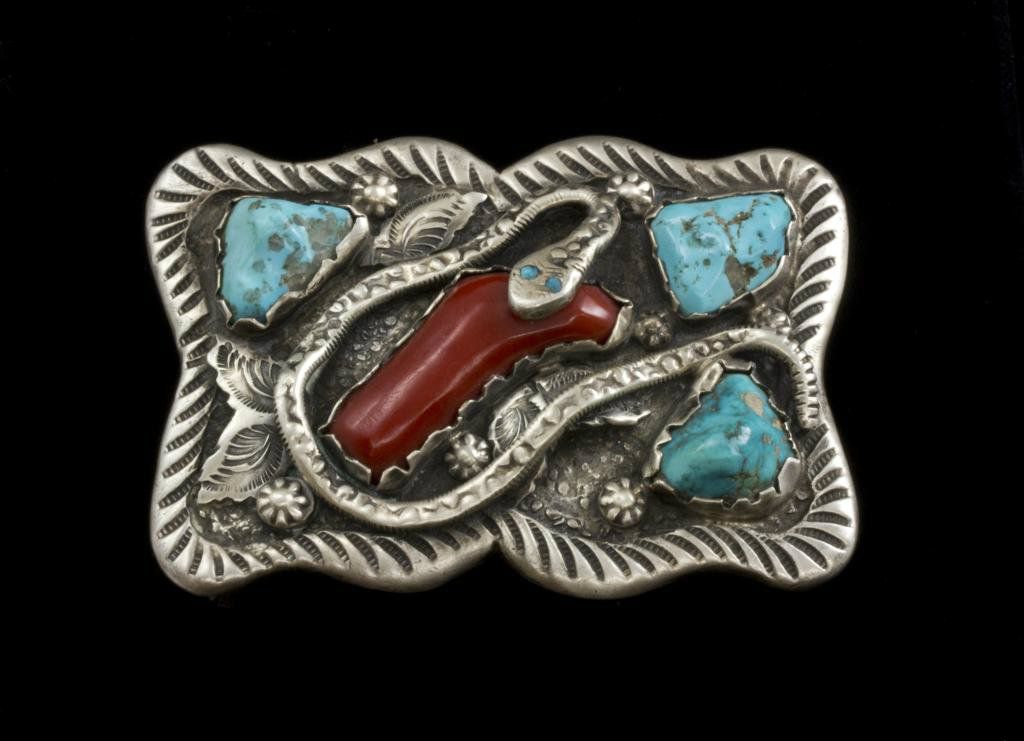

#5
f/18
0.8 sec
100 ISO
60mm
IMAGE: http://i133.photobucket.com/albums/q64/yitzachm/Bolo-441_zps68a6dbe4.jpg

Jan 31, 2013 01:58 |  #2
lots of dust
a tad soft
and a little flat
So if God made Man & Woman....whats his excuse for Nikon...

On a crop sensor, anything over f/16 causes the images to be very soft.Try f/8 or f/11 to get better sharpness.

I tend to agree. Most lenses are sharpest 2-3X stopped down from the maximum aperture, & all of these should have been just fine at f/11.
I'm wondering how you tripped the shutter? Remote cable, or self timer?
How big a crop are these? And you've sharpened after resizing, right?

hey guys thanks for the tip on the f/stop.
I didn't know the T's suffered from softness up there...I cranked it up the f/stops because on the first few shoots I noticed that the DOF was way shallow. Being 24" away doesn't help there I guess...at least not at f/2.8
PhotosGuy, I just started using my laptop with the Canon EOS Utility to trip the mirror, then the shutter.
If I go down to f/11, the shutter speed should go up enough that I don't necessarily need a remote, right? Or no?
Thanks for the Sticky link...I'll be reading through that today at work. :)
I crop first...to the 1:1 image, then resize. With Bolos it's a bigger crop than with belt buckles.

Lots of good advice here. No need to go with a crazy high aperture. The dust is a big problem with an easy solution: use a rocket blower to clean meticulously the jewelery and the background.
There is also plenty of room for improvement in the post processing. I did "freaky details" (Google it, it s a free action from Calvin Hollywood), burned the most obvious dust, did a mild UnSharp Mask and got a much punchier image. With the original raw and a little more time you will get much better than what I am showing you here. -I purposely did the one you hated ;)
Also, critical for product photography, is the accuracy of the colors. I would invest $100 in a color checker (probably the passport wold work for you) and calibrate before each shoot. Takes 30 seconds to do. This ensures that the client will see the same piece he will receive.
Good luck with this new adventure!

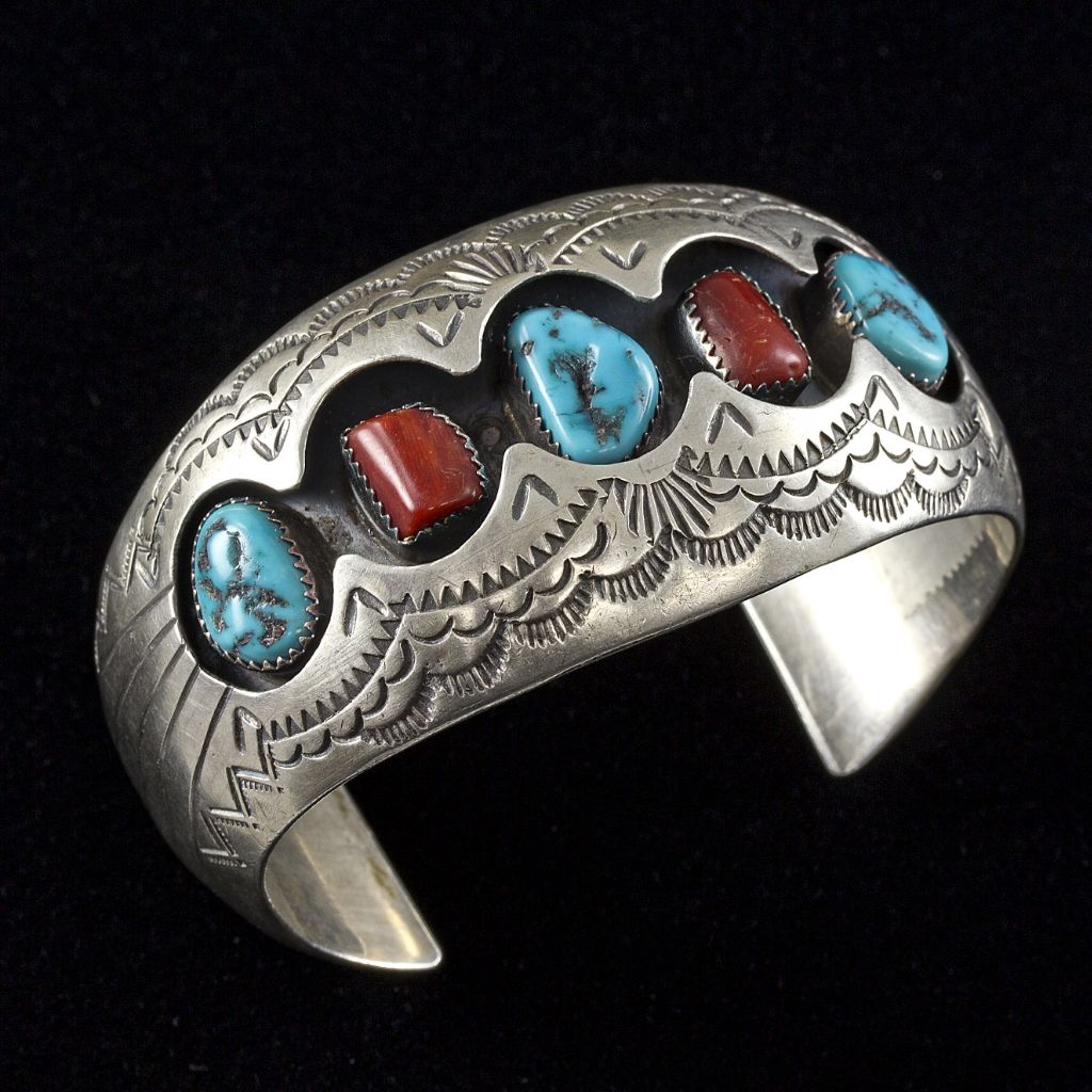

In the meantime, I'm almost getting the hang of this:
IMAGE: http://i133.photobucket.com/albums/q64/yitzachm/Bracelet-191FD.jpg
