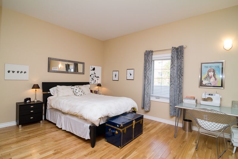

I usually do the Photoshop thing. This one was ambient only. In Lightroom I created multiple virtual copies and tweaked the white balance on each to get the tones I wanted, then imported them into PS where I used a little masking. In the end I used a bounce umbrella fired into a bed sheet hung on the wall to illuminate the shadows side of the bed better. Since so much daylight was coming in it didn't make any sense for me to gel my strobes to match tungsten.
IMAGE: http://farm9.staticflickr.com/8196/8444877571_1785aa18e5_c.jpg
IMAGE LINK: http://www.flickr.com …/37701636@N07/8​444877571/  (external link)
image (external link) by Brendan.Dillon (external link), on Flickr

Holy crap, way to many blown highlights in this image.
bdillon wrote in post #15571717 (external link)
grow up, it is only a critique of your imagery, not an attack on your personality

inaflash wrote in post #15573486 (external link)
looks like just the window curtains are blown to me...

Feb 04, 2013 23:40 |  #12
questionmarc wrote in post #15573536 (external link)
No. The lights are a little, as well as the bedding. It wasn't the final result, nor was this an architecture shoot. It was a boudoir shoot in a 5 star hotel. That was the only image I had on my ipad to upload at the time. I did a few shots to document the room for my portfolio to justify the $300.00 expense to clients.

Feb 05, 2013 00:24 |  #13
bdillon wrote in post #15573599 (external link)
im just saying i'm looking at a larger file size of it on your flickr and on my screen only the windows look blown out to me

Feb 05, 2013 07:14 |  #14
There's no rule that says light sources can't be overexposed. The window is a light source. Unless you want to draw attention to the view then there's nothing wrong with blowing it out.

Feb 05, 2013 09:14 |  #15
questionmarc wrote in post #15573707 (external link)
I took a second look and you're right. There's still plenty of detail elsewhere.
