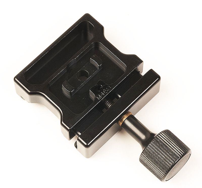

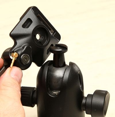

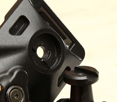

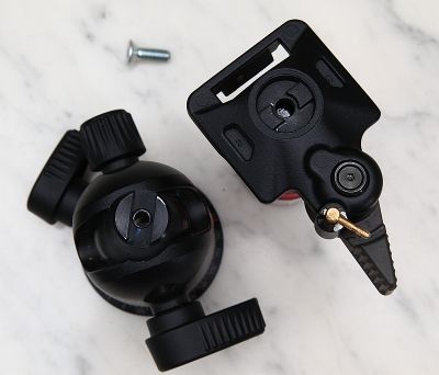

I have also been thinking about converting my 498RC2. The Manfrotto 494RC2, 496RC2, and 498RC2 all use the same quick release clamp. Yes it is a standard metric M6 screw but the "anti-rotation" cutouts on the 498RC2 stem are the opposite to what I see being used on most Swiss-Arca clamps.
EDIT: This company makes conversion kits with the cutouts correctly orientated for the 498RC2 stem.
http://hejnarphoto.blo​gspot.ca …frotto-496rc2-498rc2.html (external link)
http://www.hejnarphoto​store.com …in_page=index&c​Path=16_41 (external link)
Hejnar Photo M496RC2F62 2-piece desinged for Manfrotto 496/498 stem

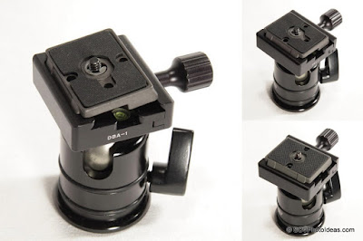

Desmond makes a DBA-1 conversion kit that accepts both standard Manfrotto plates and Swiss-Arca type plates: http://www.scvphotoide​as.com …manfrotto-arca-clamp.html (external link)
I like the idea of being able to use two different style plates on one clamp and it only costs about $30 on ebay: http://www.ebay.ca ….l2736&_nkw=Des​mond+DBA-1 (external link)
IMAGE: http://4.bp.blogspot.com/-ys41m8vS088/UGDxup6jR_I/AAAAAAAAEXA/NRIWnuImEiw/s400/Desmond-DBA-1-10-12.jpg
Manfrotto 498RC2 stem with "reversed" anti-rotation cutouts
IMAGE: http://i2.photobucket.com/albums/y17/msowsun/photo%20stuff/Photo10/_001-aaaa2_zps33fab0e8.jpg
IMAGE: http://i2.photobucket.com/albums/y17/msowsun/photo%20stuff/Photo10/_001-aa2_zpseddcac00.jpg
IMAGE: http://i2.photobucket.com/albums/y17/msowsun/photo%20stuff/Photo10/_001-aaa2_zps059fca8e.jpg

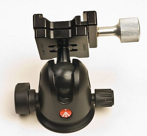

It looks like Manfrotto have released their own Arca-Swiss type clamp (external link).
IMAGE: https://photography-on-the.net/forum/images/hostedphotos_lq/2013/06/5/LQ_654570.jpg
Image hosted by forum (654570) © peter_n [SHARE LINK]

That was my post and I repeat, it's junk. The quick release mechanism is useless for anything except the included plate. It won't accept any of my Wimberley lens or body plates. For the same money they're asking for that stupid clamp and plate, you can buy a Sirui G-20 ballhead and be way, way better off.
See that light metal part on the near side of the clamp (in the photo a few posts up)? That piece is spring loaded and sinks down into the clamp when you attach the included plate. The flared bottom of the included plate is thin enough to let the spring loaded piece snap back up into place. The flared parts of any other A-S plates (at least the ones I own) are too thick to allow that piece to snap back up. And the opposite side *barely* grabs any of the flared area of the Wimberley plates. To make it worse, the spring loaded piece kept getting stuck in the down position, so I had to use a small screwdriver to get it to snap back up. Also, that pin sticking up in the middle of the clamp prevents you from sliding an A-S plate in from the ends. Your only choice is to catch one side under the far lip and then snap it down into place on the near side, which as I said, doesn't work.
