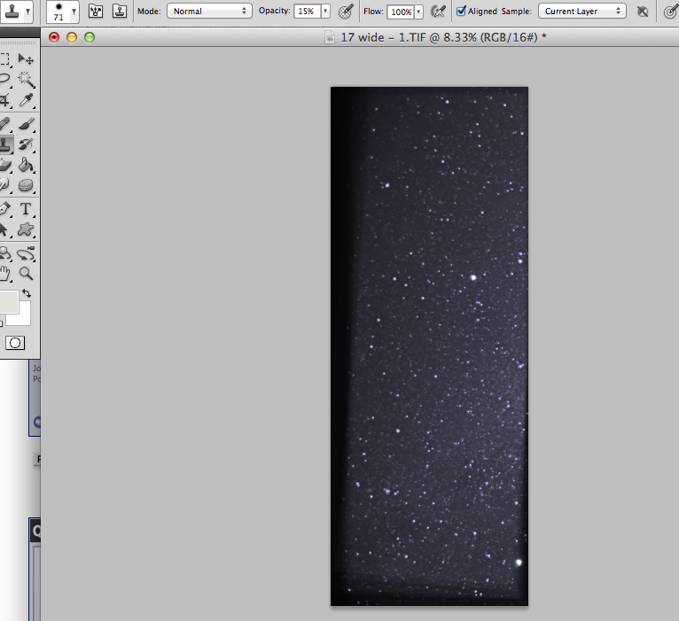

I don't know whether it's still the case, but it used to be that for newer cameras, you had to use the beta version of DSS or you got a weird image. This was particularly frustrating because there was no mention of the beta version on the DSS website, only on the DSS Yahoo group, and also because it seemed to stay in beta forever despite having no obvious problems. So, what version of DSS are you using? Your mention of getting a tall skinny image makes me think that it's too old.

screen shots:
TIFF, once exported to PS. 125 mb file, but it's an absolute mess.
Looks like this all blown out:
IMAGE: http://i133.photobucket.com/albums/q64/yitzachm/ScreenShot2013-02-19at112358PM.png

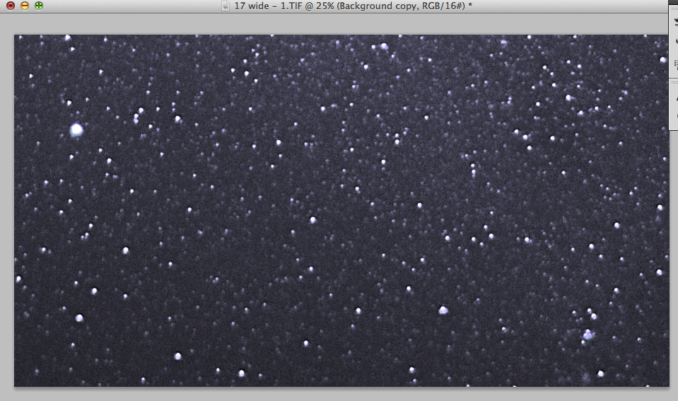

This is what it looks like up close. It's one-colored, noisy, and blase.
I've gotten better results noob-stacking in CS5 by hand, but there's so many settings in DSS
that the odds of one of them being wrong is pretty high.
IMAGE: http://i133.photobucket.com/albums/q64/yitzachm/ScreenShot2013-02-19at112621PM.png

Get the free adobe program that converts your raw CR2 files to the standard DNG and use the DNG file.

Jim ­ Shaffer
25 posts
Joined Jan 2012
Feb 20, 2013 22:36 |  #9
rogue.guineapig wrote in post #15630459 (external link)
Hey Jim,
I'm using DSS 3.3.2 and unfortunately their RAW/FITS development
Settings don't have the T3i/KISS X5/600D in there.
The latest version they have is the 400D.
Should I switch to .jpgs or pick a different cam profile?
3.3.2 is the latest version right?
Nope, 3.3.3 beta 47 is the latest, here: http://deepskystacker.​free.fr …epSkyStacker333​beta47.rar (external link)
Like I said in my last message, I'm clueless as to why they don't have a link to it anywhere other than on Yahoo Groups (some people don't like Yahoo, and for good reason), or why it's been a beta version for so long.
I don't know if it supports the T3i, but since it supports the T2i, I imagine that it would.
