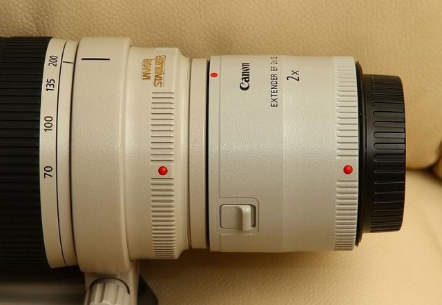

amfoto1 wrote in post #15610690 (external link)
Just to clarify....
With my 70-200/2.8 IS (Mark I), I'll use a Canon 1.4X II on it without much concern... but I won't use a 2X II... there's too much loss of IQ for my tastes. The new 70-200 Mark II and 2X Mark III are a better combo... A lot more people find the images acceptable and usable.
I didn't find the 2x III images acceptable. I would recommend the 1.4x II or 1.4x III
I bought the 2x III for my 70-200 2.8 IS II and was not overly impressed with it. The Image degradation is still noticeable and I found that I could crop a 200mm image to match the 400mm image and get similar results.
I sold the 2x III and bought a 1.4x II and see almost no image degradation. The 1.4x II 280mm images are better than the cropped 200mm images.
Check out the The-Digital-Image.com tests for the 1.4x II vs the 2x III : http://www.the-digital-picture.com …omp=0&FLIComp=7​&APIComp=2 (external link)
One other minor point.... The new 1.4x III and 2x III don't match the color of the 70-200mm 2.8 IS II or any other lens made before 2011.
IMAGE: http://i2.photobucket.com/albums/y17/msowsun/photo%20stuff/Photo10/_001_2x_zps36a3be77.jpg

Feb 15, 2013 11:34 |  #13
msowsun wrote in post #15612762 (external link)
Thanks. Good info to know and I'm checking out the link.
