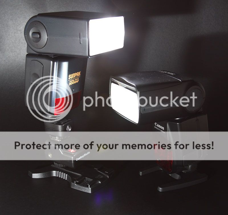

Simple. 7D's popup set to master in E-TTL. 580EX II in the picture as a manual mode free agent slave. 430EX II as main light camera left in E-TTL wireless slave mode. Old Sunpak fired with a simple CBS receiver, the transmitter being plugged in the 7D's PC port. Kludgy, but it works. ;)
IMAGE: http://i735.photobucket.com/albums/ww357/oldvultureface/POTN/7D_zpsf3b297ed.jpg
IMAGE: http://i735.photobucket.com/albums/ww357/oldvultureface/POTN/50D_zpsc9e4d142.jpg
