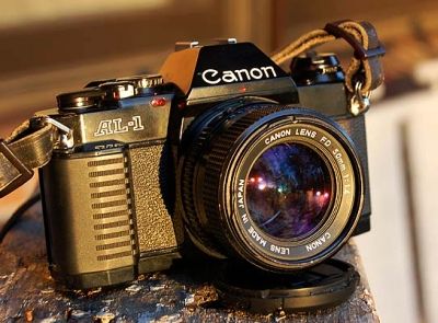

The Canon AL-1 had it 30 years ago back in 1982. They called it "In-focus indicator".
http://www.mir.com.my …ources/SLRs/al1​/index.htm (external link)
How it works: http://www.mir.com.my …urces/SLRs/al1/​index1.htm (external link)
IMAGE: http://i2.photobucket.com/albums/y17/msowsun/_001aa-1_zps9fc9813b.jpg
IMAGE: http://i2.photobucket.com/albums/y17/msowsun/_001-1_zpsc3f1bc16.jpg
IMAGE: http://i2.photobucket.com/albums/y17/msowsun/_001a_zpsc73897ba.jpg
(1) Focus frame
(2) Overexposure warning mark
(3) Meter needle
(4) Battery check/camera shake warning index
(5) Shutter speed scale (6) Under exposure warning mark
(7) Out-of-focus indicator
(8) In-focus indicator
(9) Out-of-focus indicator
