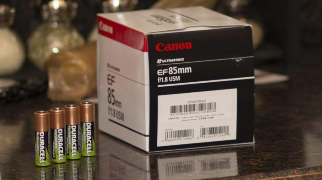

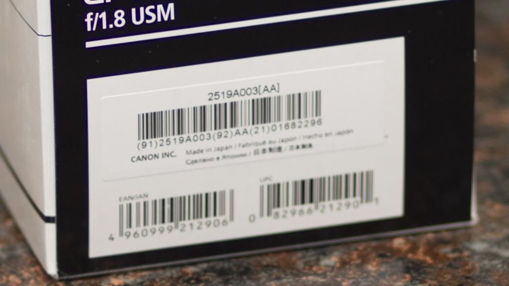

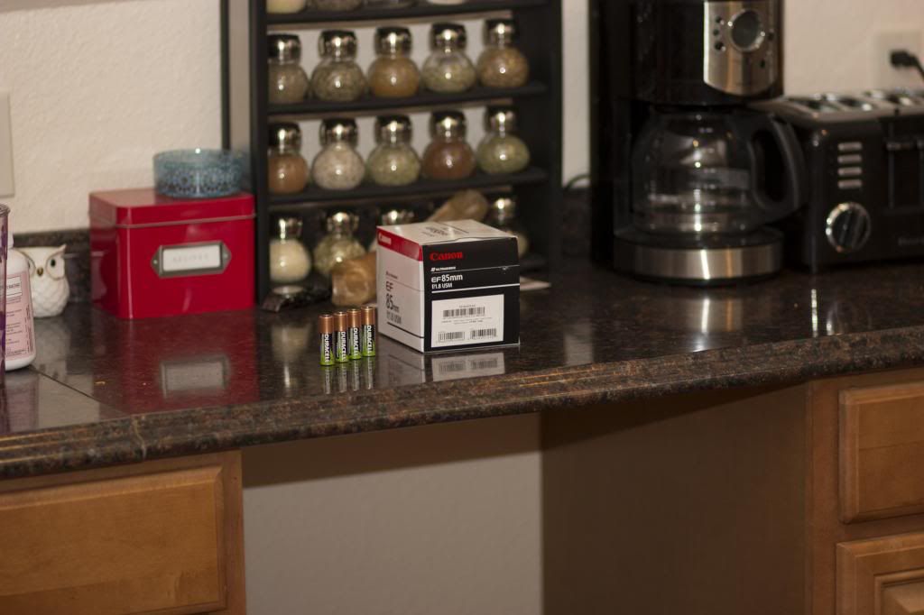

Here are two test images with 100% crops. Focus was center focus on the top bar code on the box.
60D
85mm 1.8 @ 1.8
1/200 second
ISO 100
At these settings I was testing it last night as well with my wife. If I focused on the eye furthest from me then that eye would be kind of out of focus while the closer eye was sharp. If I focus on the closer eye then they are both slightly out of focus. So I am thinking it's either a soft lens or it has focus problems. Or is this kind of expected with an 85mm @ 1.8?

The DOF at 1.8 is razor thin, so it's easy to mis-focus. But it does seem that yours is front focusing a bit. No micro-focus adjust on the 60D, right?

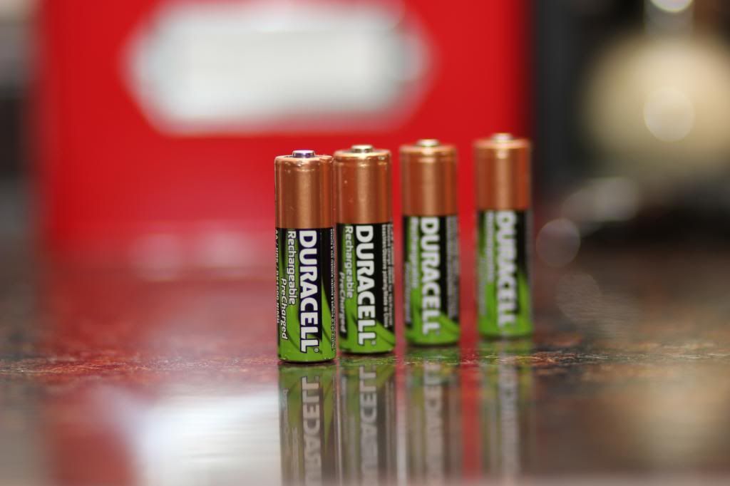

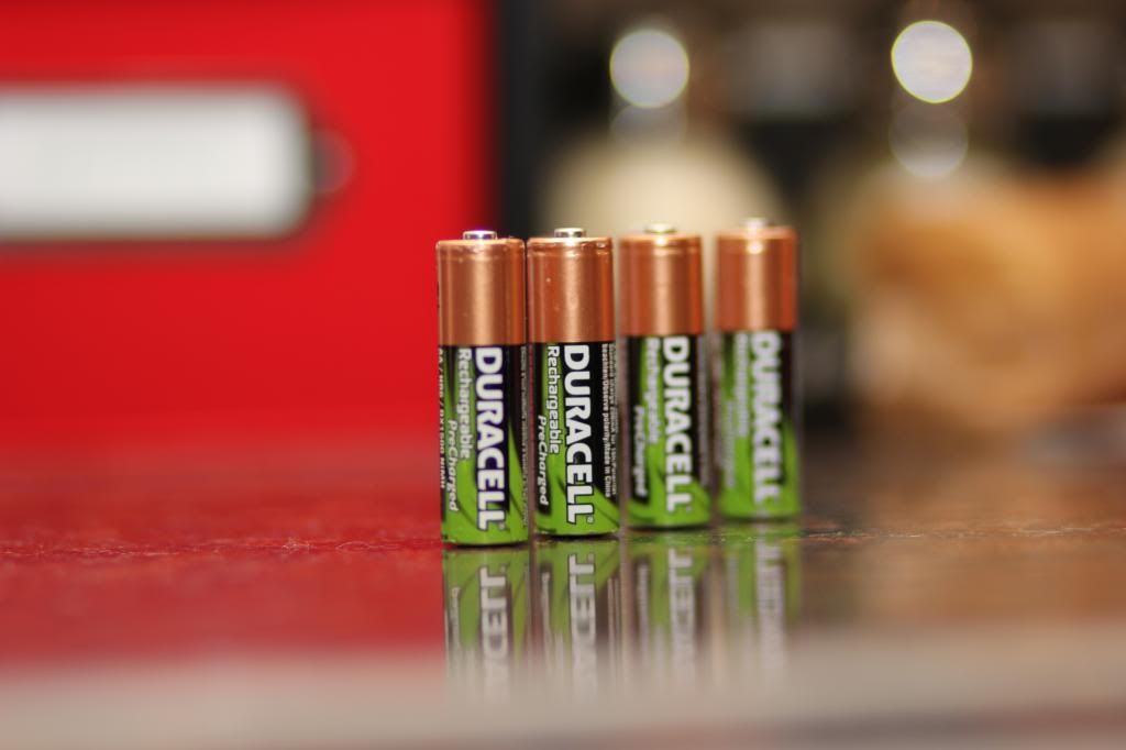

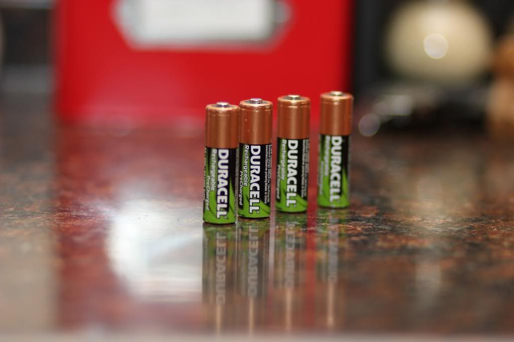

ok, here are some battery pictures. For the most part focus seemed ok. Focused on the second battery from the front. One turned out as being out of focus. Wonder why the variation...

That doesnt seem too bad to me. Its helpful when you test these wide open to have the camera on the same plane as the subject, shooting down on the batteries can affect the sharpness across the battery thats in focus.

I also did a focus test chart and it seems fine... Maybe when taking some pictures it was not just focusing well due to low light or low contrast?....

That certainly could be the case. A lot of people try to test their new gear in the house and bad light and then blame the lens. Bad light is bad light.

For those battery pictures, also move the batteries a little further apart on the horizontal plane (your front to back distance is good). The 1st and 2nd battery are kind of close together so it is also possible that the focus point may have hit part of the 1st battery on pic #3.
The arrangement you have in pic #1 is perfect, which probably also explains why the focus is the best in that picture. The arrangement in 2, 3, 4 are all too close together.
And as has already been mentioned, use the best light you can get when taking these test shots. If these are indoor, take them during the day with the windows open so you get some more light. However, based on pic #1 of the batteries, I think your focus is probably fine.
