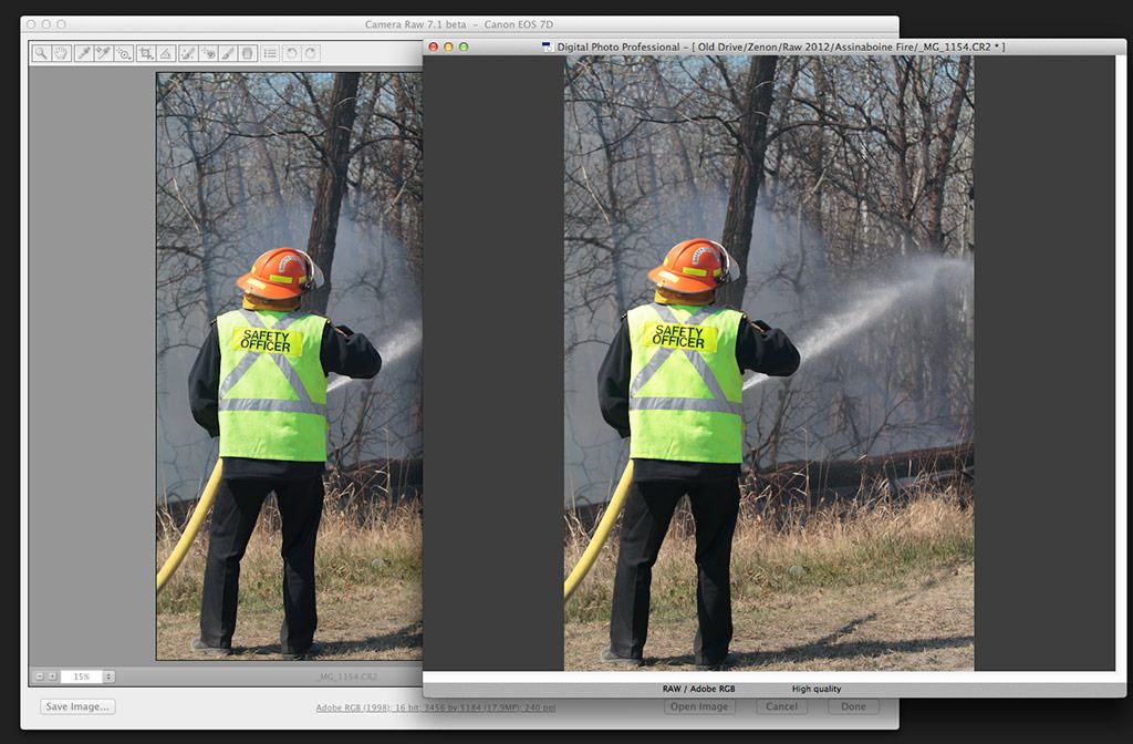

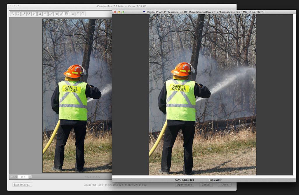

Mar 17, 2013 16:23 |  #14
Besides the 2012 process did you select the cameras profile that your camera is set to? I did some tests and Adobe has really come a long way in this area. Skin tones a are still a bit yellower but overall pretty good.
This is DPP faithful and ACR adobe standard. As you can see adobe's helmut is redder.
IMAGE: http://i33.photobucket.com/albums/d74/Zenon1/stnd.jpg
DPP faithful and ACR camera faithful.
IMAGE: http://i33.photobucket.com/albums/d74/Zenon1/faith-2.jpg
