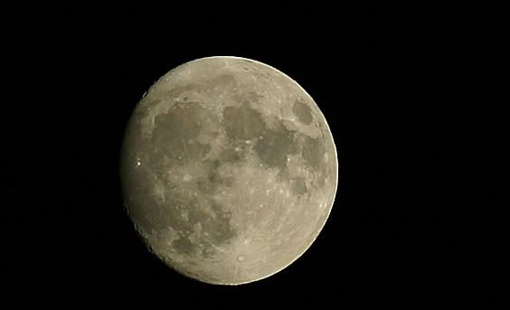

Trick is the tripod here is mine from a few months back
IMAGE: http://img.photobucket.com/albums/v471/Skydogs/IMG_7374copy1.jpg
exif
Focal length: 200.0mm (35mm equivalent: 1731mm)
CCD width: 4.16mm
Exposure time: 0.0063 s (1/160)
Aperture: f/7.1
ISO equiv.: 100
Whitebalance: Auto
Exposure Mode: Auto bracketing

Had the same problem. Have to be a completely clear day, no haze. As I am in VA where haze is always a bother. Haven't gotten any good ones yet. But a tripod, good telephoto lens, maybe use the bulb setting and a remote switch.

Bulb setting is not nec. Cause the shutter speed you want is in the 1/100th range. Now the remote, I agree with. Maybe even try using mirror lock up.....
