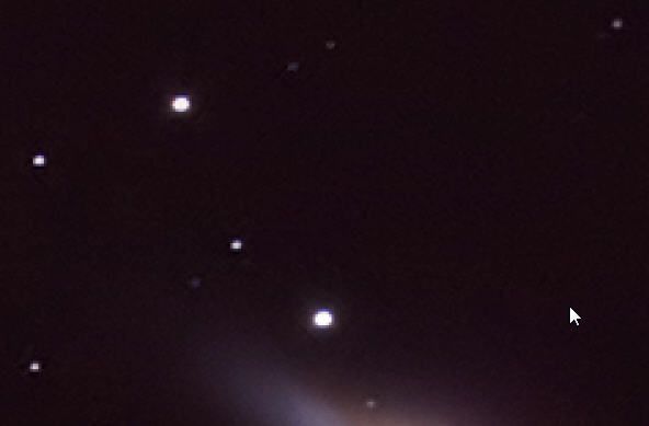

As posted, enlarged area
IMAGE: http://i69.photobucket.com/albums/i63/wiltonw/POTN%202013%20Post%20Mar1/asposted_zps730edcd1.jpg

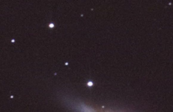

As corrected for contrast, and noise processed
IMAGE: http://i69.photobucket.com/albums/i63/wiltonw/POTN%202013%20Post%20Mar1/ascorrected_zpse55a70c7.jpg
OP, did you let the camera use its digital subtraction noise reduction during the shooting?
Perhaps your issue is also taking the shot in an area in which light contamination from adjacent cities is reflected in the moisture content of the air!

Raise your black point to push the noise down. (Curves or levels)
