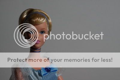

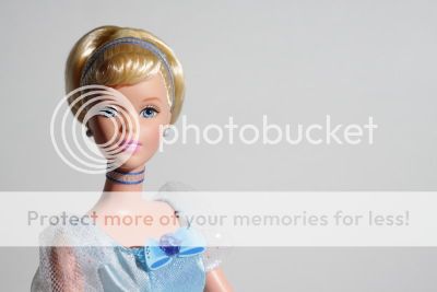

In addition to ksbal's explanation, the equivalent would be manual external metering with the 580EX II (EM mode). It works pretty well with the old auto flashes but not so well with the 580. It gets kinda-sorta close if you set ISO 100 on the flash and shoot at ISO 400 with the camera.
580EX II EM mode fired off-camera with simple trigger:
IMAGE: http://i735.photobucket.com/albums/ww357/oldvultureface/POTN/580.jpg~original
Sunpak PZ5000 AF auto mode:
IMAGE: http://i735.photobucket.com/albums/ww357/oldvultureface/POTN/Sunpak.jpg~original
Minolta 118X auto mode:
IMAGE: http://i735.photobucket.com/albums/ww357/oldvultureface/POTN/118X.jpg~original
