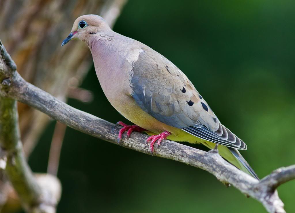

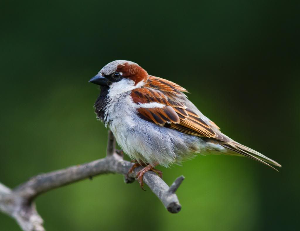

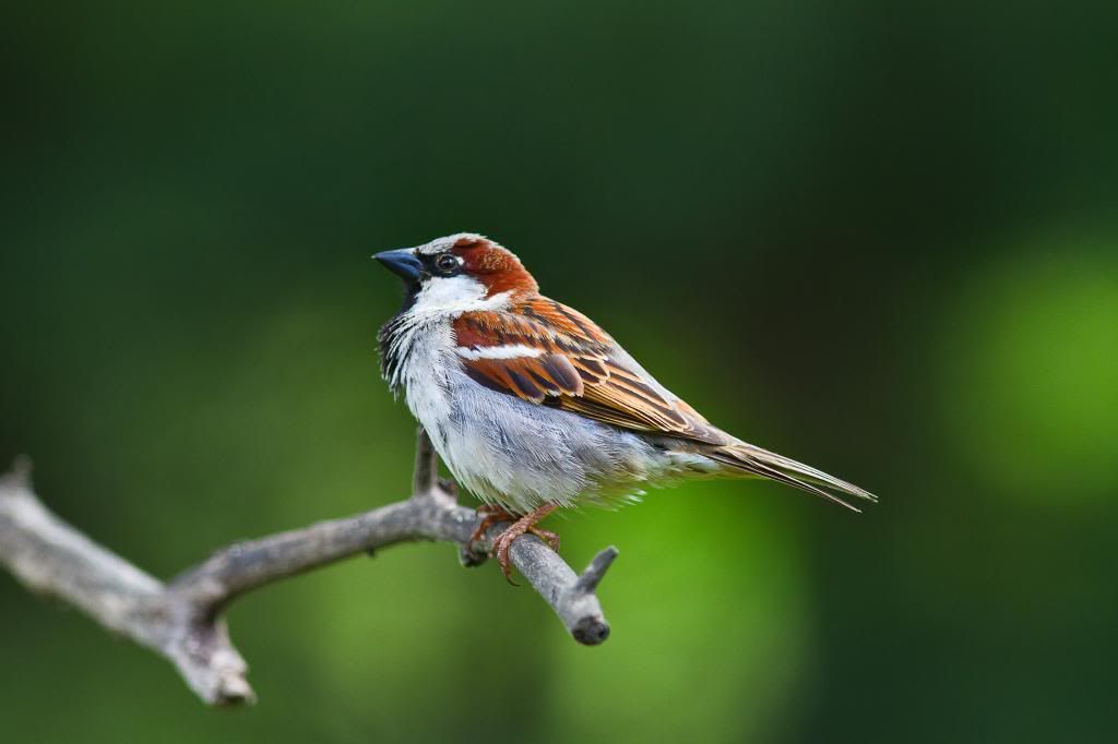

These 3 pix look clean and crisp to me as posted. But if I zoom in a couple of clicks, they're noisy as all get out! What may look fine to me maybe is making more experienced members or those w/ sharper eyes groan. Just got my new glasses last week so if the images are bad, it's probably the former. Yes, I do some sharpening in ACR and will use highpass filter some, too. Rarely unsharp mask. Try to make them look good to my eyes, but if they're bad, need to rethink. (Disregard the date-just got my 7D back from servicecenter and noticed later the date/time needed to be reset.) Thank you in advance.
IMAGE: http://i602.photobucket.com/albums/tt108/ardeekay/IMG_5776-1_edited-2_zps5a00bc52.jpg
IMAGE LINK: http://s602.photobucke​t.com …ed-2_zps5a00bc52.jpg.html  (external link)
IMAGE: http://i602.photobucket.com/albums/tt108/ardeekay/IMG_5774-1_edited-2_zpsbbb0b54c.jpg
IMAGE LINK: http://s602.photobucke​t.com …ed-2_zpsbbb0b54c.jpg.html  (external link)
IMAGE: http://i602.photobucket.com/albums/tt108/ardeekay/IMG_5775-1_edited-2_zps00294265.jpg
IMAGE LINK: http://s602.photobucke​t.com …ed-2_zps00294265.jpg.html  (external link)
Now previewing the post, they are not as sharp as in PS-Photobucket must loose a little in the process.

May 23, 2013 15:11 |  #2
Look fine to me, I know I'd be happy with them.

May 23, 2013 15:44 |  #3
I went and downloaded one of the full size images and noise looked well controlled to me. At 100% noise was visible but nothing to be concerned about.

May 23, 2013 16:00 |  #4
What are you using the images for? Big prints, small prints, web display? Your sharpening and noise control should be done with the final output in mind.

May 23, 2013 16:11 |  #5
MNElliott wrote in post #15960647 (external link)
dalto wrote in post #15960766 (external link)
Thank you MNE and dalto-encouraging to hear that maybe I'm not totally off in Left field.
nathancarter wrote in post #15960832 (external link)
Basically, for display here in bird forum and my own personal satisfaction, improving my skills. May print up some larger prints to hang in the vacation home we're building, but those would be a select few that came out of the camera clean(I happened to do everything right. It does happen once in awhile:D)

May 23, 2013 16:20 |  #6
Your images normally look great to me, Rog. In the Finch shots here, it looks like you may have been a little too close with a little too small of an aperture and wound up with the head hair OOF from having the af point on their bodies. Noise looks just fine, at this size, anyway.

May 23, 2013 16:38 |  #7
Snydremark wrote in post #15960893 (external link)
You too, Eric, are encouraging. Thank you. Also noted the OOF heads on the (Sparrows?). Trying to keep ss up for handheld on an overcast day. Don't expect to reach the skill level displayed here by so many, but if you get satisfied, the fun goes out of it, at least for me. Thanks again.

May 23, 2013 16:56 |  #8
What?  ??? Am I the only one here wondering, "What the heck?"
At 1:1 or greater, these images look terribly noisy and dithered. It almost looks like you ran some artsy-fartsy frosted-glass filter...
Check to see that the in-camera sharpening is off. Even then, try resetting all the camera's parameters to default. I also wonder if one of your programs has suffered a 'bumped' check box that is intentionally dithering or otherwise doing something it shouldn't. Try a no-frills RAW->JPG conversion and see if the problem persists. What sort of PP are you doing?

May 23, 2013 17:18 |  #9
I see jpeg artifacts as well. Compression/save issues?

May 23, 2013 17:53 |  #10
Geonerd wrote in post #15961000 (external link)
Check to see that the in-camera sharpening is off and even then, try resetting all the camera's parameters to default. I also wonder if one of your programs has suffered a 'bumped' check box that is intentionally dithering or otherwise doing something it shouldn't. Try a no-frills RAW->JPG conversion and see if the problem persists. What sort of PP are you doing?
You're blowing up an already compressed file, not looking at the original file at 1:1. So, you're seeing compression artifacts and such that aren't (shouldn't) be there in the original file.
Rog: Can you upload a full sized original of one of these files to something like Dropbox?

May 23, 2013 18:57 |  #11
To help you with that use the masking slider in the detail pallet which provides edge sharpening. I usually go about 80. If you hold down the option key (MAC) while using the slider you can see the results.
Also for final sharpening I use this method which is also an edge sharpening process. Highpass is pretty good as well.

May 23, 2013 19:02 |  #12
Also pay attention to your exposures. The 7D is not as forgiving as others due to the pixel density. Underexposing and pushing does not help. The noise in the 3 shots you posted does to look bad to me either.

May 23, 2013 19:06 |  #13
Snydremark wrote in post #15961168 (external link)
Huh? The dithering present on the large files he linked to looks nothing like any jpeg artifacts I've ever seen...
Agree that if the OP could post a lossless or very high quality jpeg of a small section of one image, that might be helpful.

May 24, 2013 07:49 |  #14
THe dithering is likely from LR/ACR's sharpening algorithm. When you increase the detail slider, this will occur. As stated above by DigitalParadise, use masking in the sharpening panel to restrict the sharpening to edges. Although I assume it is done to dither the halos that may result from sharpening, I do not like the ACR/LR sharpening approach for this very reason.
Don't zoom in a couple of clicks. ;) Some digital "grain" is probably better than trying to wipe every trace of "noise" out of an image. Even the defocused areas in the background can use a little grain to avoid the plasticky look that results from heavy-handed NR.

May 24, 2013 15:26 |  #15
Yeah, looks like sharpening (and NR) settings in LR could be better chosen.
