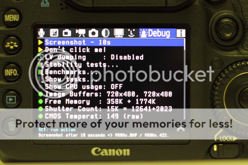

If you have the opportunity and the 7D has the latest firmware installed, format a CF card in the camera and put Magic Lantern on that card and run the camera's firmware update. The shutter count and live view actuations are shown in one of the menus brought up with the trashcan (delete) key.
IMAGE: http://i735.photobucket.com/albums/ww357/oldvultureface/POTN/IMG_3811.jpg~original
General information and download link is here:
http://www.magiclanter​n.fm/forum/index.php?t​opic=3974 (external link)
