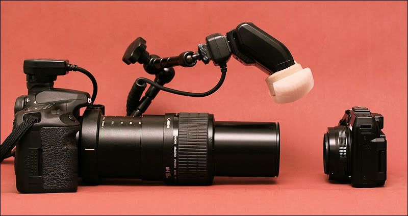

Jul 23, 2013 06:57 |  #11
I have a magic arm bracket and it works pretty well for me with either 270ex or 430ex:
http://www.ebay.com …ain_0&hash=item​3383dbabb3 (external link)
there are more options to choose from:
http://www.ebay.com …+arm&_sacat=625​&_from=R40 (external link)
