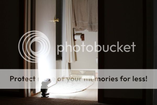

It does work with my 7D and 580EX II.
IMAGE: http://i735.photobucket.com/albums/ww357/oldvultureface/POTN/IMG_3682a.jpg~original
Make sure the on-board flash is enabled for AF assist and also normal firing. Under Wireless func., select the single external flash icon. This disables the popup from contributing to the exposure, but it will still multi-flash for AF assist. And if you're in AI servo AF, the popup won't AF assist regardless of the other settings.
I know there's a 622 under the 580 but it's not turned on. The popup flash is controlling the 580 in normal Canon optical wireless slave mode.
