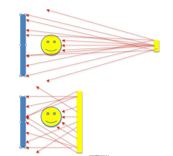

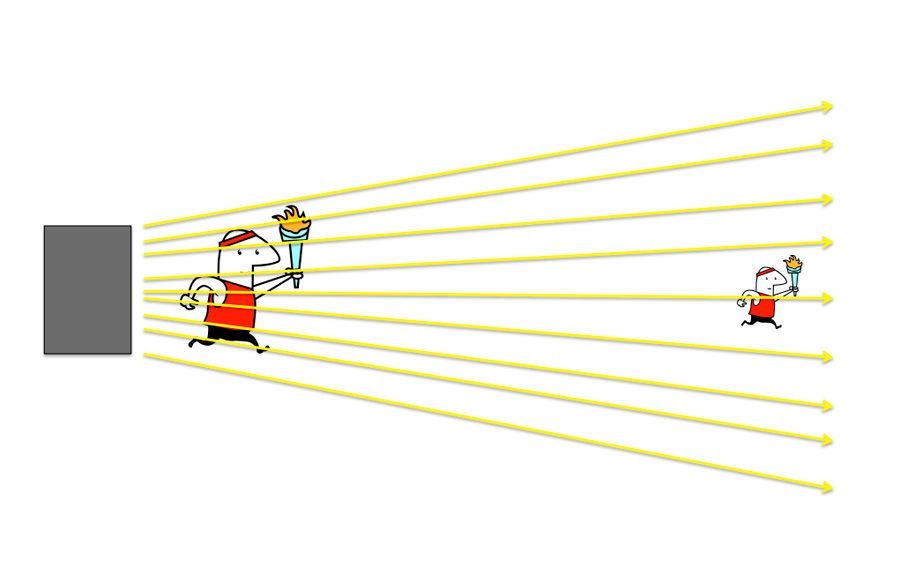

I think that article is telling me to reduce specular highlights I should make my light source larger, not smaller as in concentrating the light. You mention spreading the light. That just means more of it is going off and is not doing anything. Soft light is all about the size and distance of the light source to your subject. I'm not an expert on controlling specular highlights but my guess is the last thing you would want to do is concentrate the light source. Also there are soft boxes with baffles to prevent hot spots. Interesting to follow this.
Spreading light just does this.
IMAGE: http://i33.photobucket.com/albums/d74/Zenon1/Technical%20Fash/FallOff_zps07216efd.jpg
A large light source is the ticket. Second illustration.
IMAGE: http://i33.photobucket.com/albums/d74/Zenon1/Light-2copy_zps03d91b2e.jpg~original

Specular highlight is the direct reflection of your light source and will be the brightest part of your image. And usually, there's not much you can do to keep it from blowing out if the surface of the object is very reflective. If you do, the rest if the image will be grossly under exposed. What you do want to expose correctly is the diffused highlight area.
The smaller the light source, the brighter the specular highlight is going to be. So, if you want to control it, you want to make the light source as large as possible. This isn't done by changing the light beam spread as you described but by physically changing the apparent size of the light source. You can increase the apparent size of the light by using a large softbox or umbrella. You can even bounce the light off the ceiling or walls. The idea is to make it look like the light is coming from many different direction rather than from one point.
