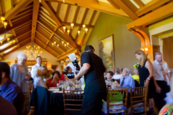

Yesterday, my wife and I went to the wedding of daughter of long time friends from college. The hired photographer used ceiling bounce with flash head slightly reversed upward in the church. Early at the reception, I saw him employ the Lightsphere Cloud (groan) for the first time. I was thinking he'd use it mindlessly during the entire reception.
IMAGE: http://i69.photobucket.com/albums/i63/wiltonw/POTN%202013%20Post%20Mar1/IMG_7841_zpsef585446.jpg
But to his credit, it was not the only lighting technique used. He did employ modifierless flash-only ceiling bounce (but rather mindlessly in other ways, I observed -- note the severe ceiling angles...he shot without paying any attention to the angle of the ceiling surfaces relative to flash position or subject position and modifying the flash aim to best suit the situation. This guy would likely suck at playing pool/billiards, I want to see how his shots came out!) And for somewhat set shots like the cake cut or garter removal, he did use radio remote trigger to fire a flash on light stand thru a translucent umbrella.
good to see this comparison drawn, i've made the same connection in my mind while shooting both billiards and photographic subjects.
