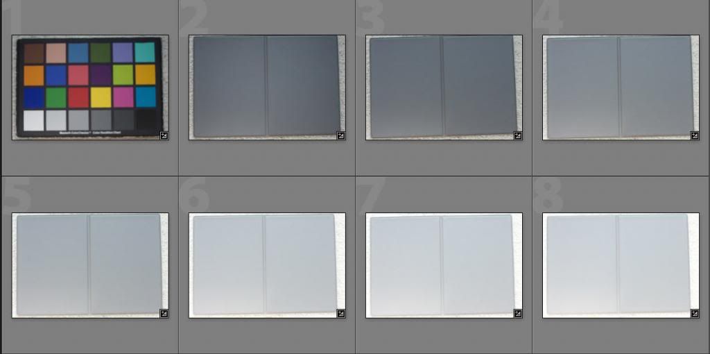

I just tested an OM lens on chipped adapter. Lens is Olympus 50mm f/1.8, chip tells the camera (40D) the lens is f/1.8, so that is the aperture displayed on the camera regardless of aperture set on the lens. Incident light meter said IS400 1/1600 f/1.8. Camera spot meter with lens at f/1.8 actual also said ISO400 1/1600. But as you stop down the lens -1EV in Av mode, the shutter speed does not step by +1EV increments. In this series, the Lightroom post processing settings applied for all RAW shots was identical (5000k, 0EV Exposure, Brightness 50, Contrast 26)
IMAGE: http://i69.photobucket.com/albums/i63/wiltonw/POTN%202013%20Post%20Mar1/meterMFchip_zps04501f5a.jpg
We can clearly see that stopped down metering was increasingly in error as the lens went thru the progression as I shot the grey card... f/1.8, f/2.8, f/4, f/5.6, f/8, f/11, f/16! All shots should have the same tonality as the first shot (f/1.8).
Shutter speed should have been 1600-800-400-200-100-50-25 progression, but instead it was set in Av mode to 1600-800-250-100-30-15-8
The same progression of metering error was repeated with meter in Evaluative mode...
IMAGE: http://i69.photobucket.com/albums/i63/wiltonw/EvalmeterMFchip_zps282f83cd.jpg
I agree fully, " Always do a test shot and review before shooting too many at any one aperture."
