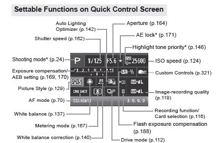

Not sure about the 7D but the 5D3 manual says the asterisk or star means you have AE Lock enabled. It may have something to do with AE Lock?

msowsun wrote in post #16147454 (external link)
Mike thanks so much for your response! I've learned a ton from you over the past 2-3 years. Your help is always clear, concise, polite and often illustrated which helps me and I'm sure others effectively grasp the subject.
The 5d3 as shown in your pic shows exactly the issue. My 7D manual doesn't show the box as having any purpose and certainly no asterisk whereas the 5d3 does.
Apparently I placed the camera in bracketing or AE lock mode inadvertently.

Glad to help. I couldn't get that asterisk to show up in my Q Menu even when using AE Lock. Auto Exposure Bracketing doesn't do it either. Did you figure out which it was?

Jul 25, 2013 05:17 |  #8
Ae lock is as easy as hitting the * button when taking a shot. Bracketing takes a bit more work, you have to be on the Q screen and when on the exposure comp box, you spin one of the dials, but then when you shot, it would take multiple shots if you have one of the burst modes on.

Thanks TeamSpeed! I'm aware of the differences and how to activate now, however I'm unable to duplicate the flashing * in the previously mentioned box between Fstop and ISO boxes in "Q"....as shown in msnowsun's pic.
It's a little troubling knowing it activated with a flashing asterisk icon unintentionally but can't be duplicated intentionally. The rest of the display seems to indicate that it was AEB and not AE Lock...but now without the blinking asterisk.

I can't get the * to show up in the Q-Menu either.

Jul 26, 2013 17:47 |  #13
When I go to the Info screen that looks quite a bit like the Q screen, and I lock exposure, the * shows up. Once the metering has timed out (period in which you can set EC, etc), the * goes out, and you have to relock exposure. I cannot get it to show anything in M, which would be logical.
It shows this also in the manual, on page 229.

Thanks TeamSpeed, I'm primarily an "M" shooter so the whole thing was a surprise to me. In every other way it displayed as bracketing but with flashing bracket and I believe flashing *
Here's Canon's take:
"Thank you for contacting Canon product support regarding your EOS 7D.
This asterisk indicates that either Auto Exposure Lock (AEL) or Auto Exposure Bracketing (AEB) had been activated. This should be reset by simply power cycling the camera, and should not come back unless you press the AE Lock button which is marked with an asterisk, or activate the bracketing feature.
Please let us know if we can be of any further assistance with your EOS 7D. Thank you for choosing Canon."
