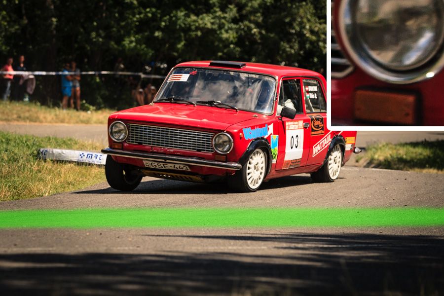

Here is a picture, that has this issue:
In the top richt corner you can see, the car being OOF, and with green I marked the part of the picture, that is in focus.

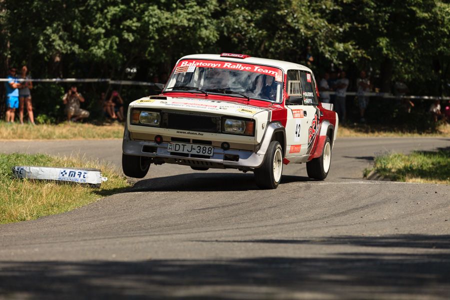

While on this picture the focus is spot on!

Jul 23, 2013 04:44 as a reply to  @ Jammin606's post |  #3
I also use a 5Dii and have found out the hard way that its absolutely vital to keep the AF point totally nailed to the same part of the vehicle. Allow it to wander even a fraction while following the action and focus can be literally anywhere.
Other than that, mine is very successful for rallies, track events etc.

Jul 23, 2013 08:34 |  #6
The fact that the focus "jumps" when you hit the shutter suggests the AF is losing the plot while the mirror is up. The predictive AF is playing a guessing game between samples and losing.

Jul 23, 2013 09:04 |  #8
NemethR wrote in post #16145968 (external link)
I was also thinking on this, but what can be done about it?!
Also interesting is, that this is not constantly the case.
Could it be that the car's changing its angle of approach and confusing the camera? In the 2nd pic the car's further around the corner and therefore further away from a predicted path...it's moving paralell (ish) rather than continuing perpendicular (ish).

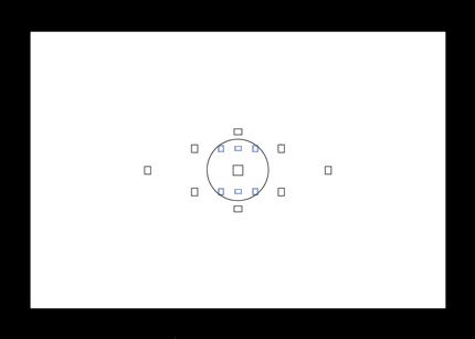

Jul 23, 2013 12:08 |  #13
Guys, before you say, 5D AF system is bad, etc...
I used, a 40D for 3 years, and before that a 400D.
Did not have this kind of issue with those cameras. Both have the 9 point AF system.
5D II has the same 9 point system + 6 hidden AF ponts (AF Point expansion).
The Actual AF system:
IMAGE: http://i1364.photobucket.com/albums/r727/NemethRoland/5D2AFsystem_zpsec4d4a75.jpg
With blue are the hidden points displayed.
Can be seen also in Ken Rockwell's review. (external link)
Again I had no problems with the 9point system of the 400D, and the 40D.
An I am quite sure, the 5D II has a superior AF system to the 400D.
