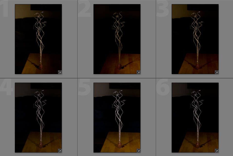

Here is a series of shots. First of all I set the light on the right with a snoot, and I wanted to set the light on the left with a grid. I wanted to feature the light falling upon the 'set' so that it would illuminate as little of the back wall as possible, and also illuminate the table as little as possible, both accomplished with 'feathering' the light falling upon the set. No complex and time consuming 'set design' here, as I was not being paid and the request was for an emailed picture 'as soon as possible'. The work was done in my family room with distracting things around, not in a pro studio without bothersome cr*p laying all around the set. That's why I needed to control how my lighting fell (didn't fall) on adjacent things.
Speedlights would make it all total guesswork, and probably not even possible without a ton of shoot and chimp shots. By using studio flash with modeling lights, I could immediately SEE how the lighting fell on the 'set' and adjust it to suit my goal, with no guess work or shooting and chimping. I wanted to exhibit the 'sparkle' via critical angling of the subject piece along with critical placement of the light. Again, that would be a total guess with speedlights, but the modelling lights allowed me to immediately SEE how the lighting could create sparkle the best at certain key locations (like at the end of the tallest piece).
now for the series...
IMAGE: http://i69.photobucket.com/albums/i63/wiltonw/POTN%202013%20Post%20Mar1/Lightingprojectstudio_zpsfa5ec8d6.jpg
...In the top row the first shot shows the right side snooted light, the second shot shows the left side gridded light, and the third shot shows the combinationof the two. This represents how my eye saw things, with no flash just the modeling lights. My positioning was done in a couple minutes, and verified. Now, time for the final shots, shown on the bottom row...
I shot three strobe-illuminated shots, at various exposure levels, to determine which exposure resulted in the most appealing balance of sparkle vs. 'ordinary' level of brilliance of the piece. Lastly, here is the shot I emailed, in which I adjusted the Tone Curve to best illuminate the piece while de-accentuating the table and background wall.
IMAGE: http://i69.photobucket.com/albums/i63/wiltonw/POTN%202013%20Post%20Mar1/IMG_8026_zps8afa7972.jpg
Home studio shooting in a few minutes effort, three shots in total (keep in mind the first three shots were simply to illustrate the process for posting on POTN and illustrate how I could SEE the results of placement!), and optimized to well present the proposed accents to my stepdaughter.

Thanks for sharing! Just a couple questions...
It looks to be 2 lights, no mods except snoot/grid, and roughly same power?
What drove the decision for 1 snoot and 1 grid?
Hard to see the difference in how the 2 lights play on the object, but I do see the softer shadow on the left (from the snooted-right, if I read correctly) -- could you tell a difference in the "quality" of reflections from each light?
And finally, if the hired gun doesn't do these objects justice, did you volunteer to PS your version in? (yeah, right!)
Light with grid was 1EV brighter than the light with snoot, according to the power dialed into the power pack. Both were equidistant from the object being photographed. In the modeling light photos, they appear equally bright because I adjusted exposure to take a shot depicting area of light coverage, irregardless of intensity differences.
BTNorris wrote in post #16171809 (external link)
I simply did not own two narrow grids! Actually, I did not own two grid holders, or I else could have used two grids of different angular cutoffs.
As both sources were equal in size as viewed from the subject position, one would not expect any difference in 'quality'. So the specular highlights ought not be drastically different. The characteristic of a grid can be seen in the shadow edge cast by the subject (below). Not casting shadows on a backdrop in my shot, I did not care about shadow edges cast by the subject.
The difference between snoot and grid -- that mattered to me -- really was the transition zone between illuminated area and the un-illuminated area at the edge of the cone of light. This comparison from the Visatec/Bron web site allows you to see the difference.

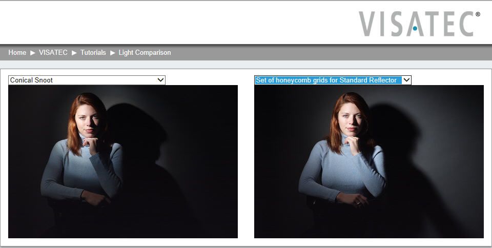

IMAGE: http://i69.photobucket.com/albums/i63/wiltonw/Principles/snootgrid_zps4b52a90c.jpg
Because the cone of light from one modifier was so much larger, I had to angle that source much more (relative to the subject) so that so much area behind the subject would not be illuminated...the feather angle was greater. The comparison seen above leads you to think snoots might always cast narrower areas of light than grids...in my case, the snoot cast a larger area of light that a narrow grid. That is why the modeling light shot taken with the snoot illuminates an area of wall, while the one with the grid shot does not.

Ignoring the question of expense, since 'digital shots are free!', there is a really tangible difference between 'illuminating' and 'lighting'.
  • trying to find the edge of the illumination field so that I could control the light field falling on the background,
  • trying to rotate the subject to the correct angle, in combination with
  • determining the angular placement of the light on the floor and
  • altering the light's elevation
  • and adjusting the camera elevation to best capture the glint
so that glints of light are strategically located along the subject being photographed in an appealing way
...would have been really tedious and and time consuming, when you cannot see the effect and have to shoot a shot and inspect it on the computer until trial and error yielded an acceptable (not optimal) result. That is the point to be learned from this thread.
The expense, in this case, is the labor and time...assuming you could even accomplish a near-optimal shot after a lot of trial and error chimping.
