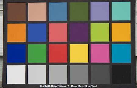

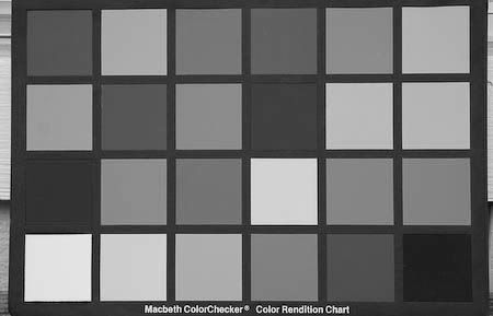

You can attempt to learn what colors map to about 18% tonality
IMAGE: http://i69.photobucket.com/albums/i63/wiltonw/IMG_5310-1-1.jpg
IMAGE: http://i69.photobucket.com/albums/i63/wiltonw/IMG_5310greyscale.jpg
You can use surrogate targets, such as known that the average palm is about +1EV brighter than 18% grey
