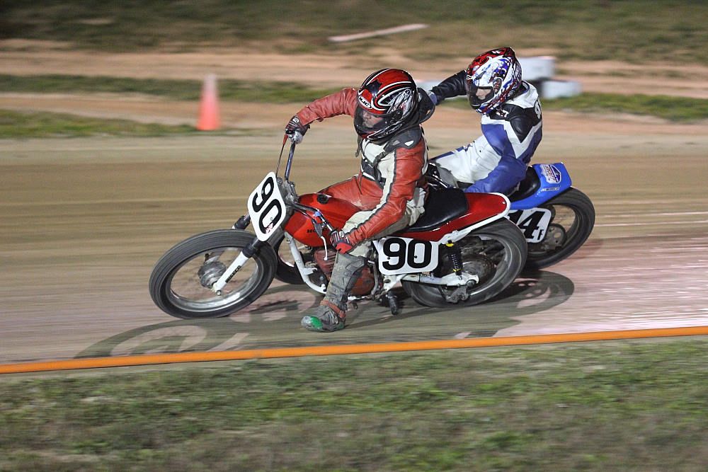

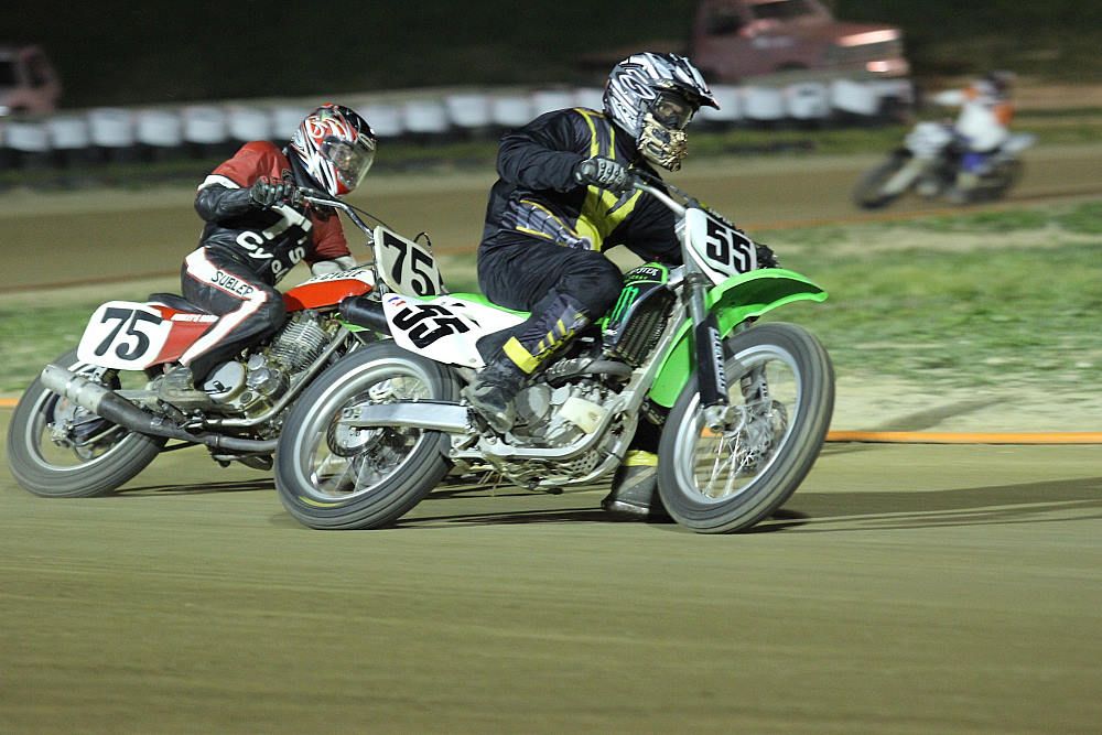

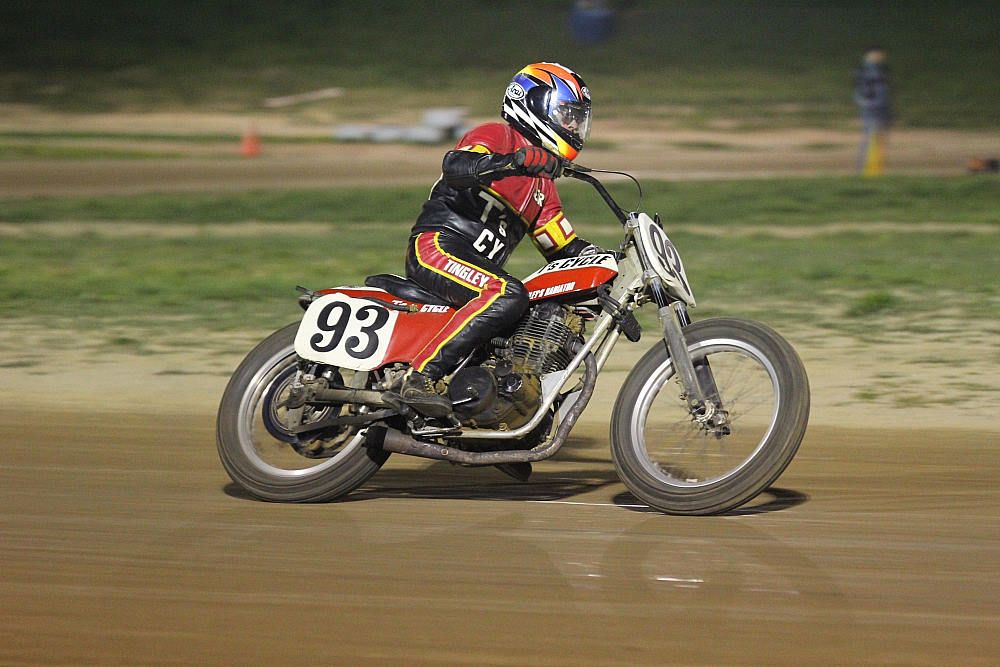

Actual night racing images. Canon 60D, non-stabilized Sigma 70-200mm f/2.8 lens. (external link)
IMAGE: http://i1174.photobucket.com/albums/r601/kevinlillard/aug2/20111029c0207_zpsf92065c7.jpg
Camera Maker: Canon
Camera Model: Canon EOS 60D
Lens: 70-200mm
Focal Length: 110.0mm
Aperture: f/2.8
Exposure Time: 0.0031 s (1/320)
ISO equiv: 3200
Exposure Bias: none
Metering Mode: Matrix
Exposure: shutter priority (semi-auto)
White Balance: Auto
Flash Fired: No (enforced)
IMAGE: http://i1174.photobucket.com/albums/r601/kevinlillard/aug2/20111029c0169_zps37fc585d.jpg
Camera Maker: Canon
Lens: 70-200mm
Focal Length: 86.0mm
Aperture: f/2.8
Exposure Time: 0.0040 s (1/250)
ISO equiv: 3200
Exposure Bias: none
White Balance: Auto
Orientation: Normal
Color Space: sRGB
GPS Coordinate: undefined, undefined
Creator: Kevin Lillard
Copyright: Kevin Lillard
Comment:
IMAGE: http://i1174.photobucket.com/albums/r601/kevinlillard/aug2/20111029c0180_zps0986d950.jpg
Camera Maker: Canon
Lens: 70-200mm
Focal Length: 135.0mm
Aperture: f/2.8
ISO equiv: 2000
Exposure Bias: none
Exposure: program (Auto)
Color Space: sRGB
These distances are far closer than what you can expect, but the exposure will be similar. This small track used the same type of bright Musco lighting found at larger tracks.
