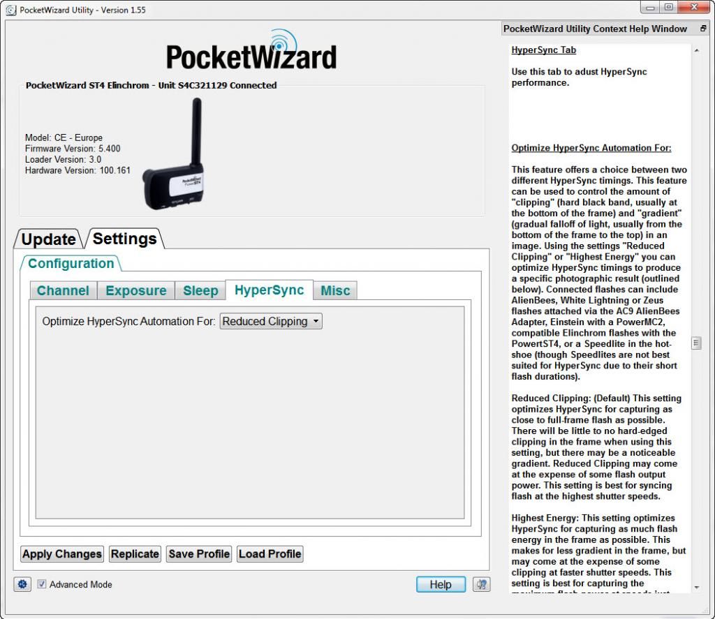

So I've recently pulled the trigger on a PocketWizard ST4, FlexTT5 and a Ranger RX Speed with an S-Head, and I'm experiencing banding/clipping issues for anything beyond 1/250s.
I plug in my ST4 into my Ranger RX Speed, and I have the FlexTT5 attached to my 5D3. I have updated the firmware on FlexTT5 to version 6.400, and my ST4 to version 5.400.
I've tried playing with the settings via the PocketWizard utility, but have had no luck. My current settings are listed below.
Has anyone experienced such an issue? If so, how did you go about in fixing it to achieve a clean image with 1/8000? Any feedback would be greatly appreciated
Thanks

After quite a bit of googling, I think I've found my answer from a previous thread:
https://photography-on-the.net …highlight=band+​st4&page=5
Sheldon N wrote in post #12620855 (external link)
You are losing exposure in that area as you increase the shutter speed, in perfect linear form with the shutter speeds. You lose 1 stop of exposure in that part of the frame as you go from 1/500 to 1/1000, and another quarter stop as you go to 1/1250. This matches exactly with what I posted in my earlier reply, pointing out that this method does not get you any additional ability to overpower ambient light.
Even if you were to use a longer duration flash to help even out the exposure over the frame, it's still going to have the same fundamental issue where faster shutter speeds will start robbing you of flash power in linear progression along with the ambient light, once you cross past the sync speed.
Seems like I forgot to correct my exposure when I was testing the different shutter speeds
Thank you POTN! :)

It's almost impossible to have a clean 1/8.000 photo.
The best way for your kit is put the TT5 only Hypersync, the ST4 in reduced clipping and the RX at full power and you get only a little ND soft grad filter effect, easely corrected in PS :)
Check this pdf: http://wiki.pocketwiza​rd.com …ReducedClipping​_Ver11.pdf (external link)
Here you have all the info in pdf with all the combinations
http://wiki.pocketwiza​rd.com …p?title=Canon_5​D_Mark_III (external link)

pspentax wrote in post #16258200 (external link)
Wow, I made such an amateur mistake! I was judging the 'clean' image based on what i saw on my camera LCD. When I had imported it into lightroom, boy was I wrong!
Thank you for the info!
