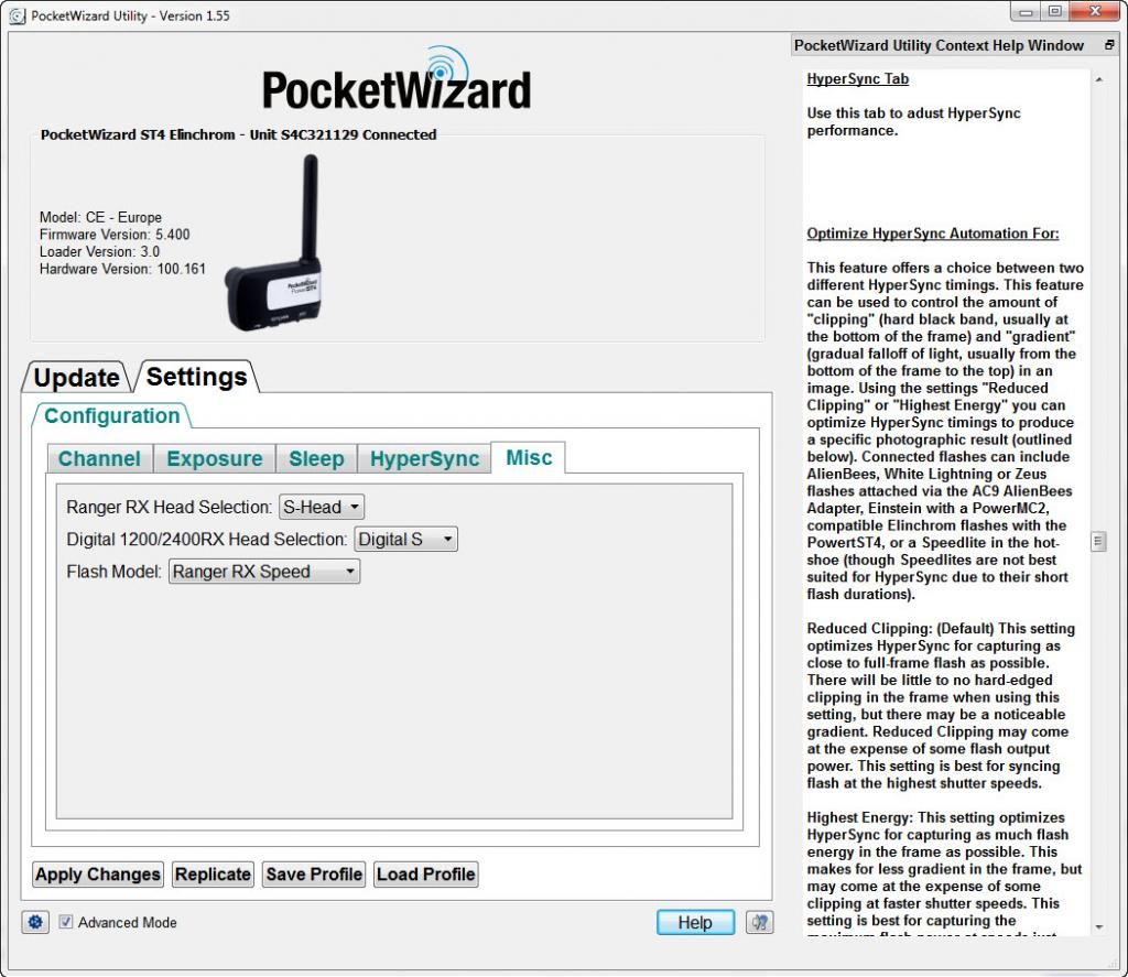

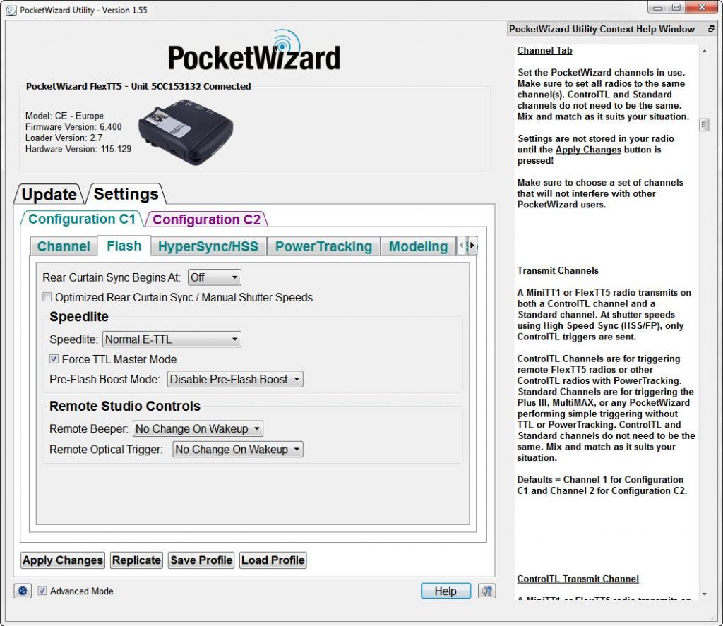

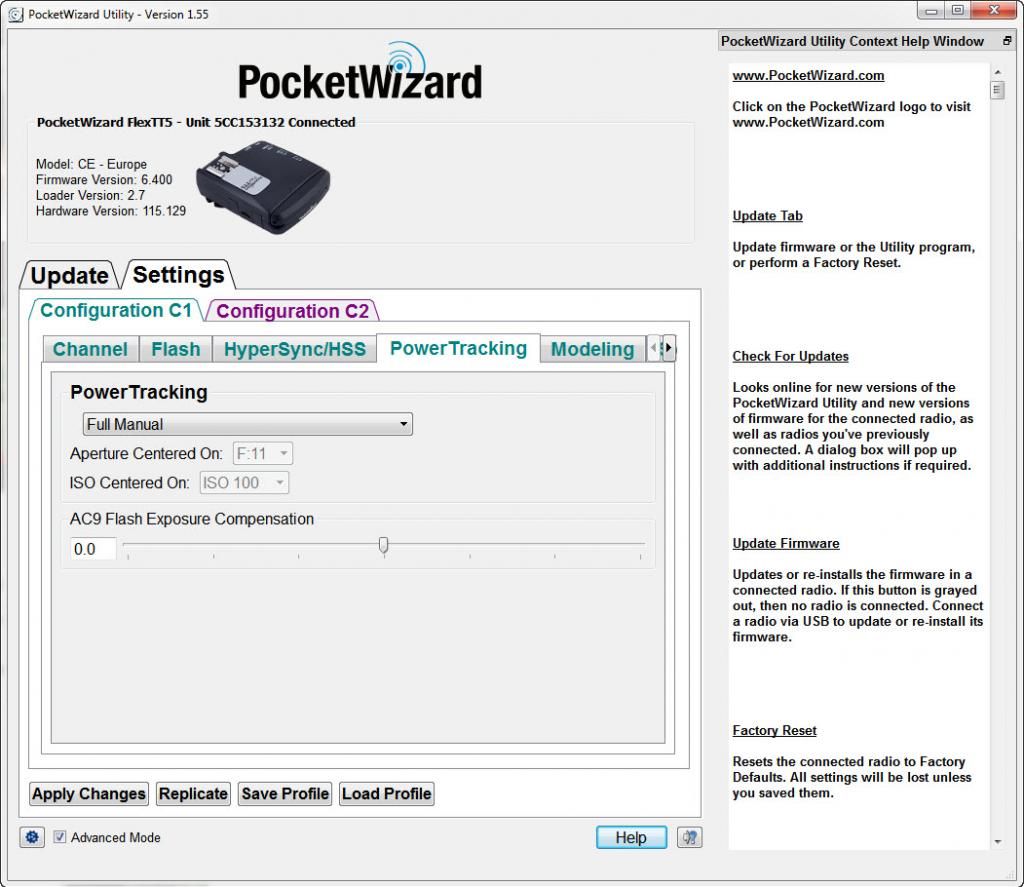

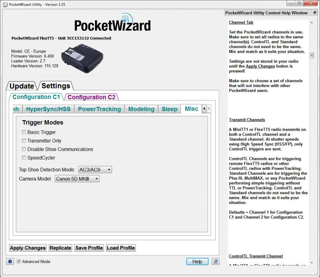

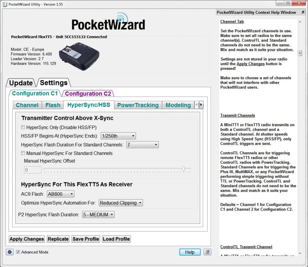

Hi POTN,
So I've recently pulled the trigger on a PocketWizard ST4, FlexTT5 and a Ranger RX Speed with an S-Head, and I'm having an issue with the FlexTT5 power tracking.
I am trying to control the Flash Power Level of the Ranger RX Speed/S-Head via the Flash Exposure Compensation (FEC) menu within my 5D3, and am noticing that the Power Level defaults back to 4.50 (bang in the middle of 1.5 and 7.5) after one shot. This happens despite the FEC being constant at say -3 (where it should stick to the minimum power level of 1.5).
Has anyone experienced such an issue? If so, have you found a solution? Is it just a matter of changing the PowerTracking settings within the Pocket Wizard Utility?
Again, my current settings are listed below. Any feedback would be greatly appreciated.
