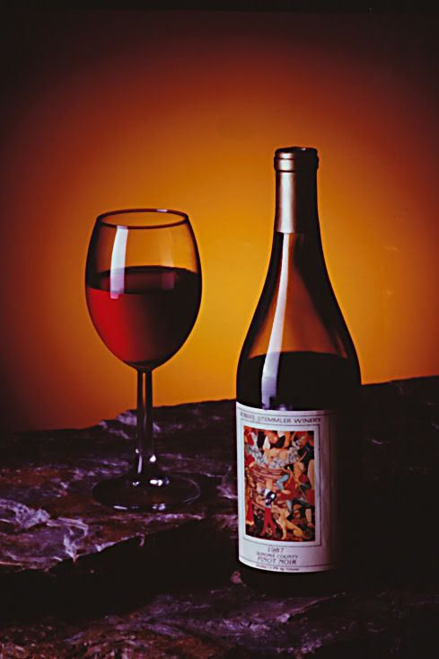

I do not believe the issue of paper imperfections showing with shoot-thru light on the backdrop is a real issue, particularly if you properly maintain more distance between subject and backdrop. This shot was made with shoot-thru gelled light through black seamless, during a commercial lighting workshop as my own exercise.

Wilt, I think its sharpening or something before uploading, but the image doesn't look sharp. Also, there are two lighter spots on the light part of the background just to the right of the bottle. They look like they could be thin spots in the paper.
Both are apparently artifact of my scanning from an Ilfochrome print. I just looked at the originaly 645 format transparency and neither blur nor light spots on background are evident at all. The original shows also much better shadow detail, like in the base of the glass of wine and the set area to the right of the wine bottle. I have the original in an exhibition mount, and did not want to destroy the mount in order to remove the transparency for direct scanning, so I scanned a print. The print looks fine for sharpness, too, although the Ilfochrome print does suffer the contrast gain and loss of shadow detail that it is famous for.
