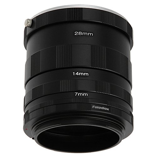

I am FREAKING out! Today I bought a cheap Fotodiox macro extension tube set and, or course, immediately connected it to my camera and 100mm macro lens. I read that people have had trouble getting it off the lens, but not me....I can't get the camera mount tube off the camera - and I DID NOT tighten it very much...I'm just hoping someone has a suggestion about how to get it off the camera!!!

is this
IMAGE: http://ecx.images-amazon.com/images/I/41izd-6TvOL.jpg
your extension tube set?
