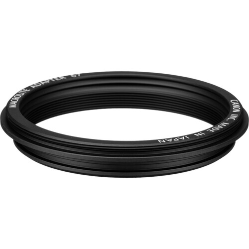

Thread started 26 Sep 2013 (Thursday) 07:24
Canon 67 Macrolite Adapter
Shift7
90 posts
Joined Apr 2011
Sep 26, 2013 07:24 |  #1
Hello, is there any other cheaper alternative for Canon 67 Macrolite Adapter (100L IS + 14EX)? I am asking, because in my country it costs 45$ ;[[I think it is too much for such small thing.
IMAGE: http://static.bhphoto.com/images/images500x500/656030.jpg
orionmystery
12,078 posts
Likes: 771
Location: Malaysia
Sep 26, 2013 09:25 |  #2
Yeah...really overpriced for simple adapter like this. Cheapest you can get might be ebay. 39US$ including shipping.
Kurt
Malaysia & Borneo herping/macro tours:
http://www.orionherpad​venture.com (external link)
Shift7
90 posts
Joined Apr 2011
Sep 28, 2013 03:38 |  #3
racketman
21,936 posts
Gallery: 20 photos
Likes: 2480
Location: Richmond Surrey
Sep 28, 2013 05:40 |  #4
I haven't had much joy using ring or twin flash with 100mm lens, you might be better off with normal flash off camera.
Toby
Shift7
90 posts
Joined Apr 2011
Oct 02, 2013 01:57 |  #5
I have Macrolite 14EX and 100L, before had generic 100 mm 2.8 - this speedlite was quite awesome and joy to use. I could take photos without any hassel.
Beside thath I have Pocket Wizards and many 550EX, 600EX and 420EX flashes. How you find these are better than special flash dedicated for macro? :D
racketman
21,936 posts
Gallery: 20 photos
Likes: 2480
Location: Richmond Surrey
Oct 03, 2013 03:51 |  #6
I find the macro flashes work best for ultra close ups, prefer 430ex and similar for 100L. Mind you I am fed up with the MT24EX, keeps breaking, I think it is going in the bin, i've spent enough already repairing it. The MR14 seems more robust.
Toby
OrnateWobbegong
69 posts
Joined Jul 2013
Location: UK
Oct 03, 2013 08:06 as a reply to  @ racketman's post |  #7
Yes its a rip off :-( I'm sure I read somewhere that you could get a cokin adapter but I may be wrong it was a while ago when I was searching for an alternative and I just ended up opting for the canon one.
I'm not a macro expert but I have been quite happy with the result of my 14EX I like the convenience of having it fixed directly to the front of the lens. I've struggled using standard flashes with brackets and diffusers due to the bulk.
I would love to have a go with the 24EX as it seems vey flexible!
7D | 100D | 70-200 f/2.8 L IS II | 100mm f/2.8 L | 24-105mm f/4 L | 10-22mm f/3.5-4.5 | 50mm f/1.8 II | MR-14EX | 270EX II |
1,878 views & 0 likes for this thread, 4 members have posted to it.
Canon 67 Macrolite Adapter
Latest registered member is Sandro Bisotti
1603 guests, 159 members online
