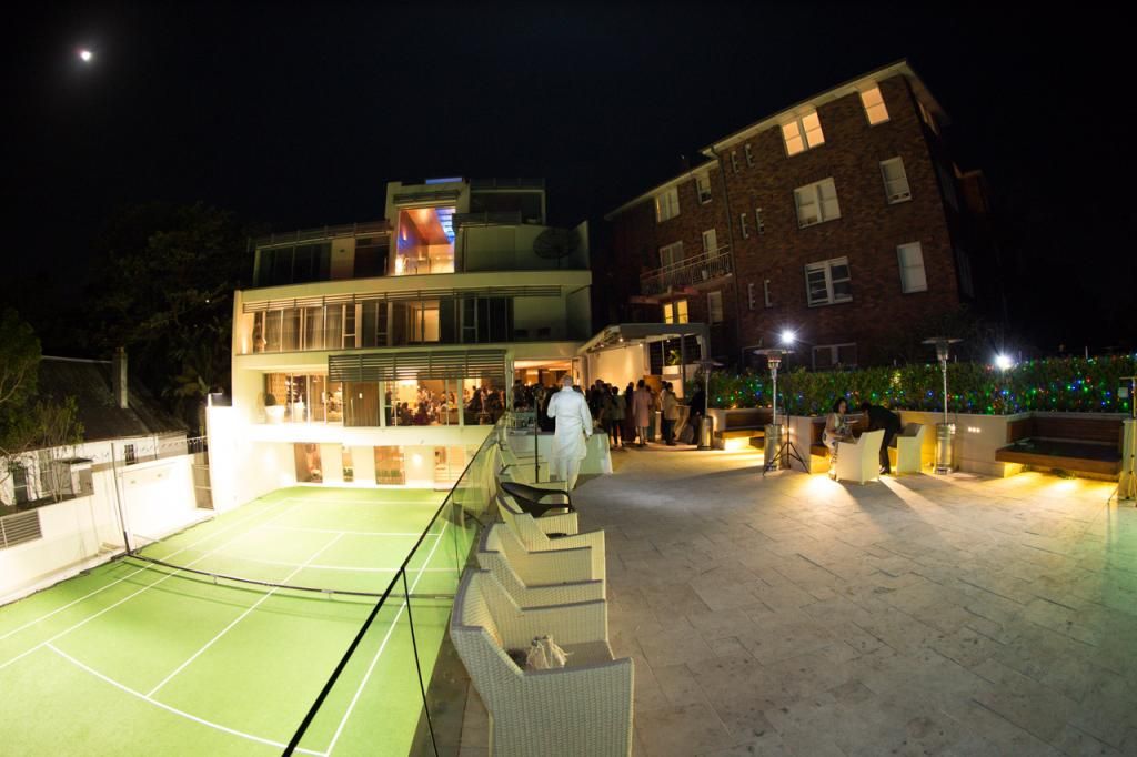

good news is that I managed to find some ambient from the down lights of the house (ie the house was in the background).

And this is a long exposure of what the venue looked like (I'm not delivering this photo but just thought you guys might be interested)
IMAGE: http://img.photobucket.com/albums/v169/v_kalra/20131019-21-58-59-_G1A1870.jpg
