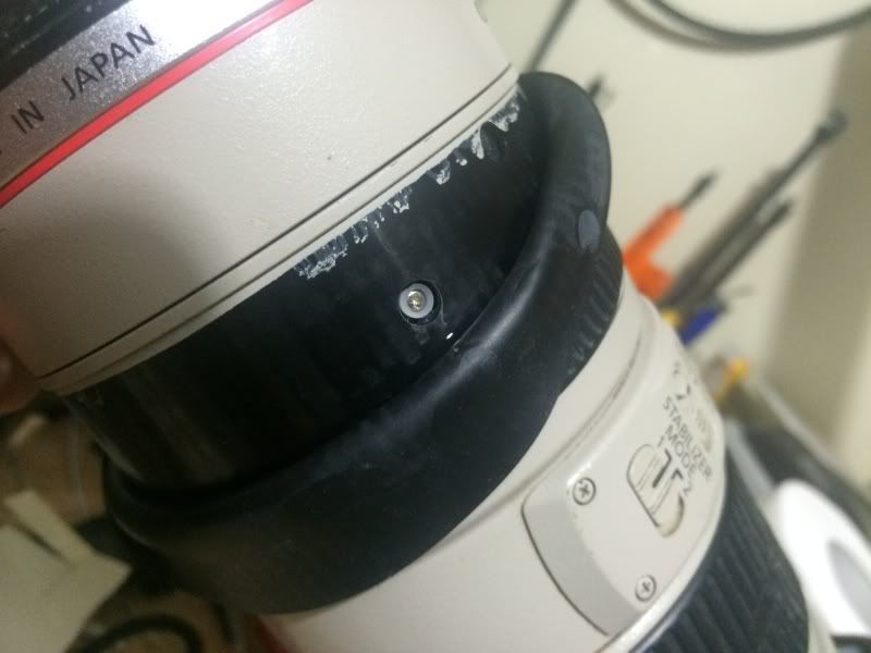

Simple fix - grab a small (000) sized screwdriver, peel the rubber ring off the focus dial carefully - somewhere around the lens will be hole, and a screw has backed out of the lens body far enough to jam in the hole - put the screw back in the hole properly (you may need to take it right out, line it up and screw it in again) and then replace the rubber.
I will take some pics of what I mean when I get a chance (hopefully tommorow) (will have to find my broken 16-35, or remember when I get to work)
For now - here is an example showing a 70-200 - you can see the screw quite clearly, they don't back out of the 70-200 body far enough to jam the focus ring like they do on the 16-35, but it shows how to access them anyway.
IMAGE: http://i103.photobucket.com/albums/m150/Echo63/null_zps61d63826.jpg
While your in there, tighten the rest of the screws too - once the focus ring is unjammed you should be able to turn it around freely, and see a few other screws to tighten.

Got it fixed by a specialist who took a mere minute or two, yup, it was the screw that had come loose
Told me that it wouldn't affect the warranty so long as I knew what I was doing
The screw does come loose on this lens
