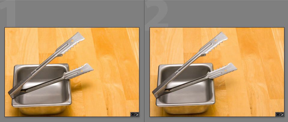

As for Assumption 2...bouncing the light over a larger area of the ceiling will make it 'softer'....but not 'the same results as #1 (since #1 is not valid). For these two shots, I put the flash in Manual and manually selected the flash coverage angle. On the left is 85mm coverage (APS-C) and on the right is 20mm coverage (APS-C), both ceiling bounce in a standard home ceiling height.

As for Assumption 3, not all photos are best done with super 'soft' lighting...you lose details that the eye uses as visual hints of texture, for example. Portraiture pros often find that somewhat 'harder' light is useful to give older men more 'character', although they use softer sources to minimize wrinkles in female subjects.

Thanks Wilt. You have two inch metal 1/6th pans at home?!
Yeah, photography isn't my ownly diversion. I've got an immersion blender and a Chinese hat and a mandolin, too!

See again my post 5 photos, for examples of spreading the light to make an even larger virtual source (ceiling), resulting in increased softness of light (less apparent shadows).
As stated by others, a wide direct source by zoom head (not bounced to ceiling) does nothing for softness, it affects only the area of light coverage.
CurtisN forks demonstrate that when you are using reflections, like with chrome forks, the area of the illuminated surface is larger and therefore you see it in the chrome's reflections...Not because the light is 'softer' but merely because the area of the ceiling which is seen within the reflection has become illuminated.
