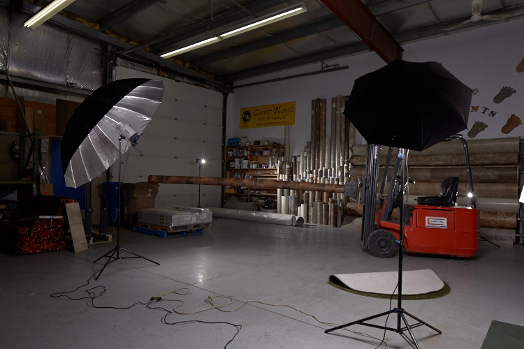

I tried the parabrolly recently. Take a look:
This was the setup. (external link) 7' Westcott parabolic to camera left, and 32" white regular umbrella to camera right.
