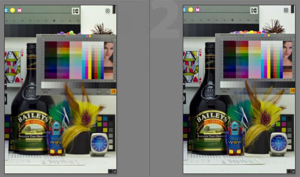

HappySnapper90 wrote in post #16458086 (external link)
I disagree. As exposure increases, saturation decreases. This is what people said about "under exposing slide film to increase saturation" although the concept isn't valid. Under exposure leads to darker photos. People consider darker to be more saturated.
Will this convince you otherwise? The eyedropper values of box 11 of the greyscale from both shots is 22-22-22, and box 11 of the Kodak color chart is 33-33-33, for both shots from 60D and T31...same exposure. Same saturation values in both LR settings, and here is the side by side. Note the saturation of the colored feathers, visibly more saturated colors in the photo on the left from the 60D than in the photo on the right from the T3i. The Kodak logo is also more saturated on the left, than on the right.
