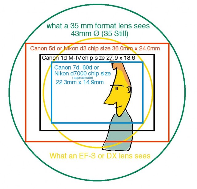

I did not have this issue with my old 60D. I am guessing it must be because the 5D Mark III is a full-frame sensor. I do not use lightroom, just Photoshop CS4. Some of what you guys are saying is greek to me.

so the 8-16mm is designed for cameras like your 60D...so the image that it will give is not large enough to cover the sensor of a camera like the 5D...so you're images are showing a lot of black because of the fact the lens isn't designed for your camera
this image may help you:
IMAGE: http://www.filmanddigitaltimes.com/wp-content/uploads//2011/05/Lens-vs-chip-Christofori-640x612.jpg
IMAGE LINK: http://www.fdtimes.com …ull-frame-vs-aps-c-and-h/  (external link)
from this site:
