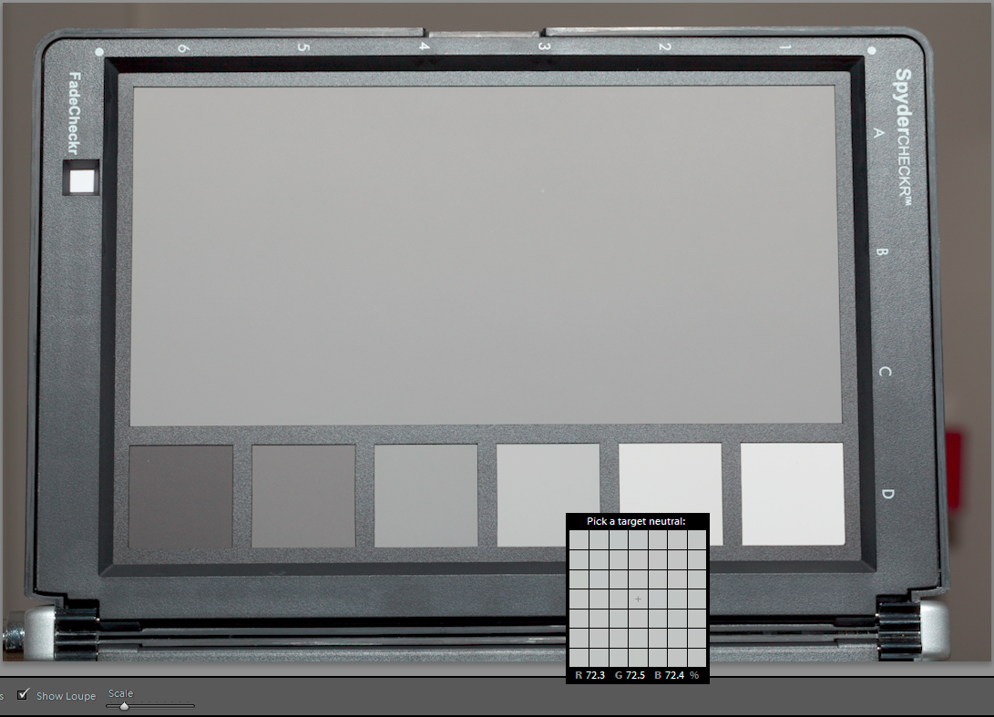

I'm trying to get the WB 'right' for my studio lights and having a bit of a hard time. Whenever I use a colour target/grey card, I find the WB goes too much to the green side for my liking when using the WB dropper to adjust the temperature in my RAW processor. If I use the Flash (or Daylight) preset in the RAW processor the image doesn't always look 'nice': it's quite warm, although that certainly gets it out of the green and pushes it towards the magenta. Now, I don't know if that's the way it's supposed to be: warm. Guess what I really want is to find the fundamental value, the standard if you will, from which I can then creatively deviate.
I've shot a grey card in an attempt to set a custom value for the camera. Mind, my camera is normally set to use Daylight. I only change its WB setting when shooting under fluorescent lighting.
What would be the best approach for finding and setting that 'standard'?

After setting the WB, have you checked the RGB values of the target to see if they are even?

Nov 21, 2013 23:29 |  #4
Scatterbrained wrote in post #16471021 (external link)
They are but for decimals.
Here:
This is before (external link) the correction. The values (in LR, as I also use C1 Pro and they are not consistent in their scales) are: Temp = 4850 / Tint = +1. The camera had been set to Daylight WB.
This is after (external link) the correction. Values are: Temp = 5200 / Tint = -8. Daylight WB in camera. Does this look too green to you?
Now, setting the camera to a custom temperature using the frame linked below, yields the following results:
Before correcting (external link). Values: Temp = 5250 / Tint = -10.
After correcting (external link). Values: Temp = 5200 / Tint = -10.
Again, are the last two images too green? I did note that the RGB values are all the same in the last, corrected in LR, shot.

They don't look green to me. When's the last time you calibrated the monitor?

Try shooting the card again and tilt it downward slightly. If you look closely (especially on the sides) you can see straight on glare from your light(s). You will get better and slightly more accurate results when the glare in taken away

Two issues might be the problem: you grey card isn't truly 'neutral', your monitor is not truly 'neutral'.
Kodak grey card, Whibal, Photovision, EZ Balance, ColorChecker, and Douglas are all 'neutral'. Of these, all can be used for measuring exposure -- except for the light toned Whibal.
If you neutralize during postprocessing using LR, your image on the monitor ought to end up neutral, unless your monitor is improperly adjusted and not showing neutral grey as neutral! Bad color calibration tweaks can also throw things off, even if the monitor itself is fine.
This is a perfectly neutral (128-128-128) color that should allow you to assess your monitor.
