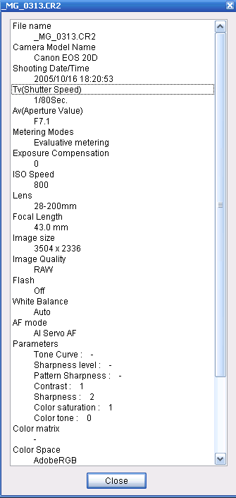

I have a picture here and most of the people in it turned out pretty well except for the kid on the left hand side. It was getting dark, and it was literally my last shot of the day because I was losing shutter speed fast by then. Looking back, I should have done this pose first when it was brighter out, but I'll just have to save that for next time. Anyway, the boy on the left and the one in the middle were moving just a little more than the others when I took this (if you were to look at the sequence, you can see he was skipping and acting goofy and the little one was bouncing). My question is,
How big of a print do you think I could make from this image? They love the pose and feel of the picture, but my concern is with the blurred boy on the left and the little one in the middle. Would it look OK blown up to say 18 x 12 or bigger? I am hoping that the longer viewing distance of a print like this would make up for a little blurriness in some spots. Comments welcome!!
EXIF:
IMAGE: http://i11.photobucket.com/albums/a176/cbass94/Untitled-1.gif
I gratefully allow photo editing of this image for this thread.

It would help to know the resolution of the original. I'm guessing the image you posted here has been scaled down and it looks like it's suffered some softening in the process. I took it into PSPX and managed to recover some detail and sharpness with Noise Ninja and Focus Magic but without knowing/seeing the original it's pretty hard to say for sure how well it would print at 18x12.

Very true, sorry about that, I guess it would help if I posted up some EXIF too.
It has been resized, but I didn't touch anything other than reducing the size of the image. Also, if there's any way I can post a link to the full-size image, I would appreciate someone telling me how and where I can host it. Imageshack and Photobucket (what I usually use) limit the file sizes. Thanks!
I've added the EXIF data to the original post.

So I guess the original is 8mp which means at 18x12 you'll be printing at around 200dpi. I would think with some sharpening work, maybe selective in some areas it shouldn't be too bad. You could always test print a cropped region of the tricky areas to double check before getting the full size print done.
